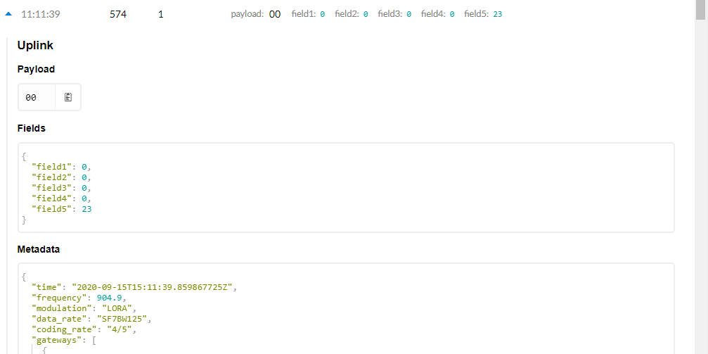

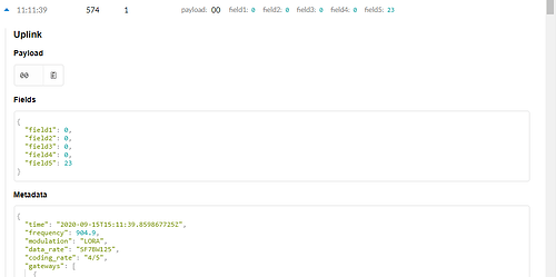

After changing theses files, the frequencies displayed on ttn has changed, please see below:
captureTtn
And don’t worry buddy I know all the stuffs you mentioned before, that’s why I was concerned about it :slight_smile:
I think it’s due to the RN2903 chip that can work on European frequencies to, and the fact that the things uno tried to connect with my gateway ( set-uped with european packages)… it might be why I saw frequencies like 868MHz on ttn before (it doesn’t make sense I know haha). But please if you have clues about that, feel free to share your ideas :slight_smile:!
Or it could be (with high probability) the fact that I missread the things displayed on ttn console haha, and the frequencies like 868,865 MHz displayed were from the gateway and the node has always been correct … By thinking about it, I think that was that…
