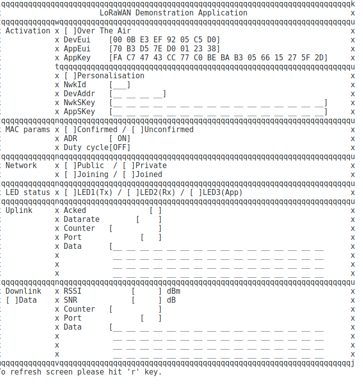

I use the same DEVEUI, APPEUI, APPKEY like in CubeMX example and there isn’t any join activity. Maybe its problem with version 7:5077515 of LoRaWAN-demo-72 ? I have LoRaWAN-lib files at revision 12:d405d2dd43b9, SX1272Lib files at revision 12:d405d2dd43b9 and mbed revision 170:e95d10626187.
The image below shows my VT100 application status
screen-lora

Hi @Smetanin, I decided to try this for myself, knowing that a few months ago it used to work. I found a NUCLEO-L073RZ board and added the SX1272 mbed shield. I used the current version of LoRaWAN-demo-72 with the mbed online compiler and can confirm that it no longer works, just remains at joining and I cannot see any traffic on the gateway - I need to look into this further. Incidentally, I note a similar result from @BFH_SAM2 - I-CUBE-LRWAN V1.2.0 and TTN - join problems
