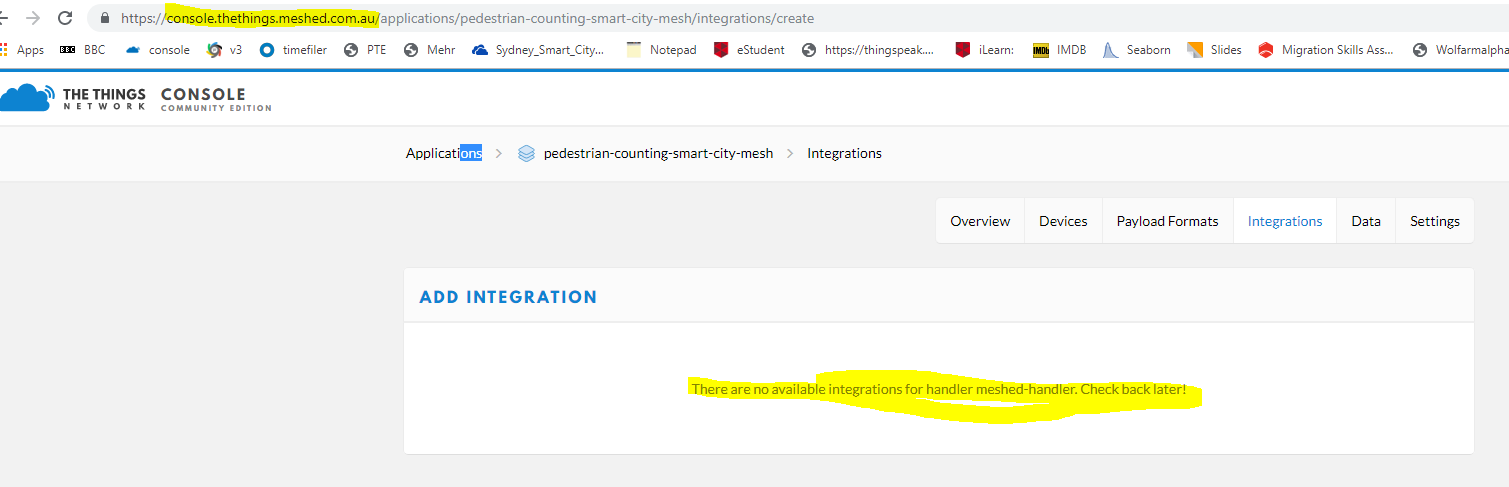

meshed-handler is currently offline when I’m looking at one of my applications from console.thethingsnetwork.org When looking from console.thethings.meshed.com.au it states ‘App … not registered to a handler’ Moreover, meshed-route is no longer an option to select for a Handler. Is there a status/monitoring site for all the services, handlers, integration providers? Is anyone else experiencing the same issues with meshed-handler?
Yes, mehed-handler is currently down. See Australia - Meshed Handler Down.
@Maj Andrew, is there still problems with the server?
Integrations are still not shown on the meshed console.
Yes, I have the same problem
Yes looks like Integrations are still a problem. Restarting the integrations had no effect. I’ll ask the TTN Core team to look into it.
Resolved now
Ohh, I just found this post, while writing a query with the subject “There are no available integrations for handler meshed-handler. Check back later!” Luckily the related post search system sent me here.
