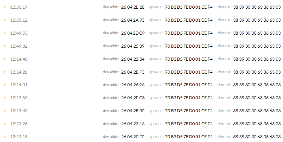

As your TTN Console screenshots show a value for DevAddr, TTN actually accepted the Join Request, and probably indeed commanded a gateway to transmit the Join Accept. Most likely, the node did not receive it.

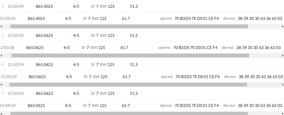

Here I am attaching the some SS that I did not receive the uplink message please help me with that how can I resolve this problem.
It’s hard to tell from your screenshots which Join Accept (green icon) goes with which Join Request (orange icon), but it seems the timing might be tight. Like: assuming that the 12:49:59 Join Accept goes with the 12:49:53 Join Request, then that’s about 6 seconds difference, while for RX1 it should be 5 seconds, and also needs some time to send the Join Accept to the gateway. (The frequency and SF of the Join Accept shows that it’s supposed to be RX1, not RX2, which for India would be 866.550 SF10.)
