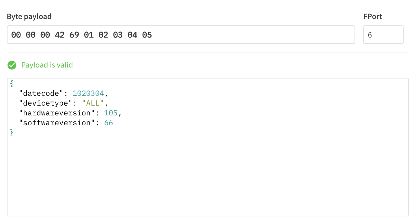

This is not functioning (my webHooks endpoint receives an empty decoded payload). So, I have tried using the device “Payload formatters” tab to test some payload formatters. There I have tried augmenting the default code below to include “input.fPort” like this:
function decodeUplink(input) {
return {
data: {
bytes: input.bytes,
fport: input.fPort
warnings: [],
errors: []
Pasting in an actual payload from one of my devices of “AQMBJAhyACUBAAA=” this resturns an fport value of 1:
"bytes": [
0,
0,
170,
0
"fport": 1
yet when I look at the JSON “Event details” in the console “Live data” for the device it clearly states f_port is 6, and 6 correlates to what I would expect:
