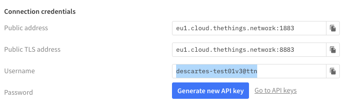

Here’s the Python solved for you:
The user name is YOUR_USER_NAME@ttn - example highlighted in blue below.
In v3 the MQTT integration page will show you this and there is a big blue button to generate the API key which is the password.
Screenshot 2021-05-29 at 10.56.07
You should be able to use the same credentials for Node-Red.

“@ttn” was missing … i tried it but it wasn’t working either … because my “password” was wrong too !
I had generated a new “API key” but didn’t copy it immediatly. I copied the API key from “Go To API keys” wich is different !
So now i have downloaded the certificate for TLS, and i can see my python app and my Node-red app connecting in the ttn V3 console. I can collect the data from the whole of my application (#) with python and Node-red, and now i will update my code to decode the JSON.

That, for anyone else reading along, is the API ID, the one you can use to manage the API Key with using the API for keys …
It is categorically NOT the API Key aka the Password - you get one chance to see / copy that and then, poof, it’s gone in some magic smoke with, presumably, some sort of hash held in the TTS database.
