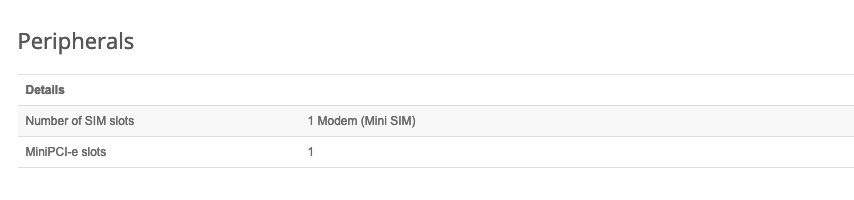

On MikroTik Routers and Wireless - Products: wAP LR8 kit it shows:
BUT, it also states:
*) the device has no built in LTE modem, the SIM slot can only be used, if LoRa interface card is removed and replaced by an LTE modem
So… :frowning: :joy:
