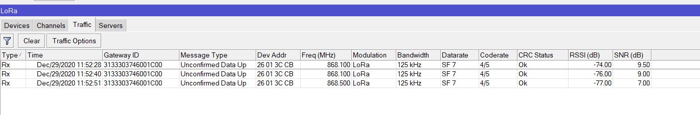

new Mikrotik gateway and it’s been 2 days since I try to have a connection under TTN. My gateway is receiving the data, but I am not receiving anything in TTN. Currently it is connected in ethernet to my box. I followed several “tutorials” like:

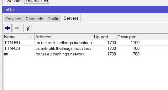

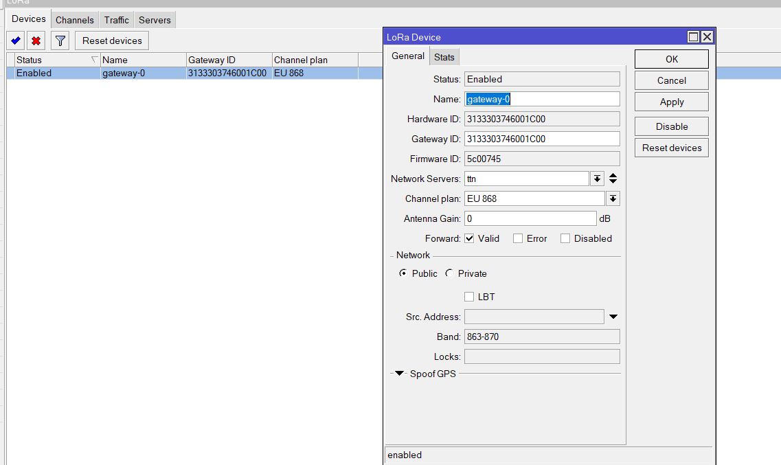

Lora configuration:

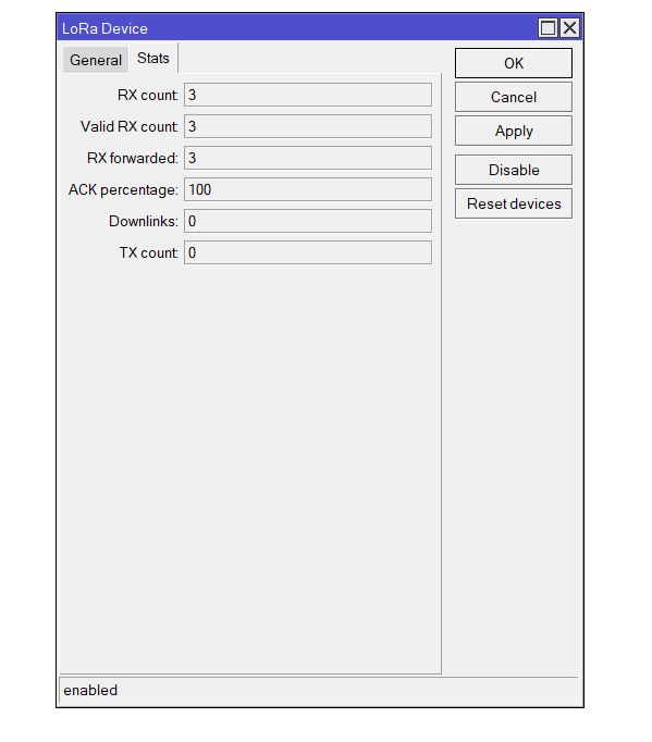

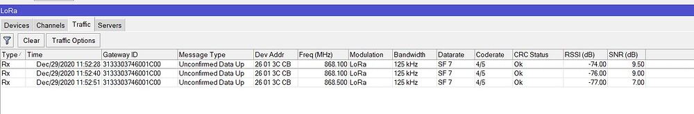

LoRa > Devices, double click yours, switch to Stats tab

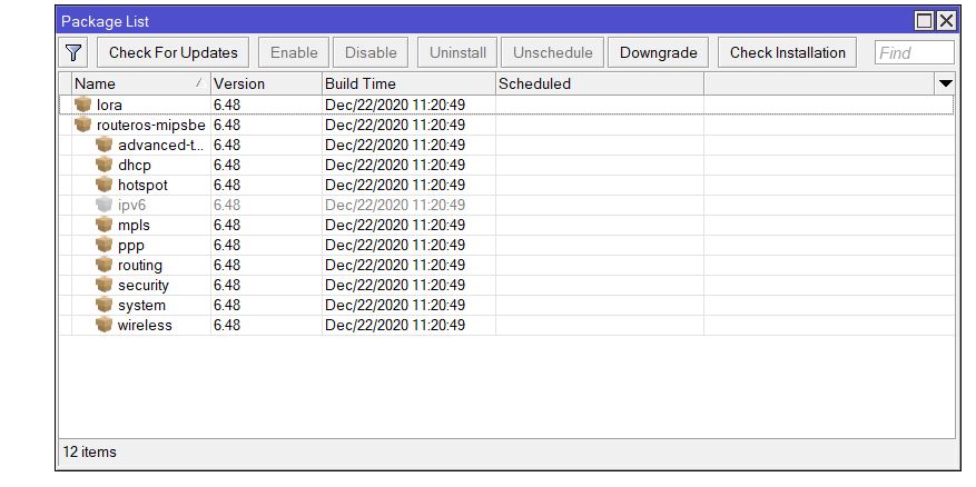

system > packages

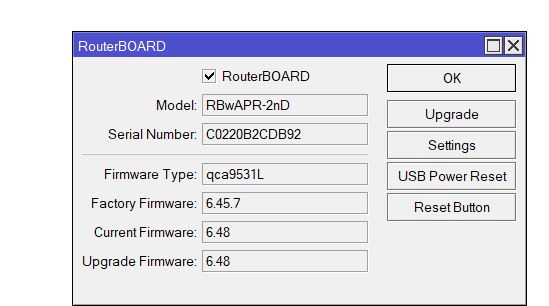

system > routerboard

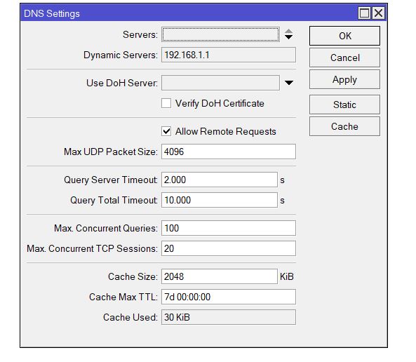

IP > DNS

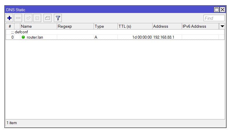

IP > DNS [Static] button

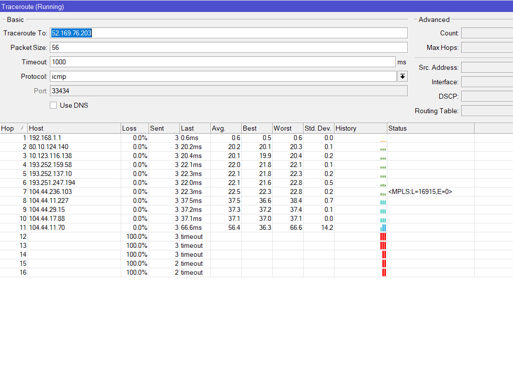

tool- traceroute

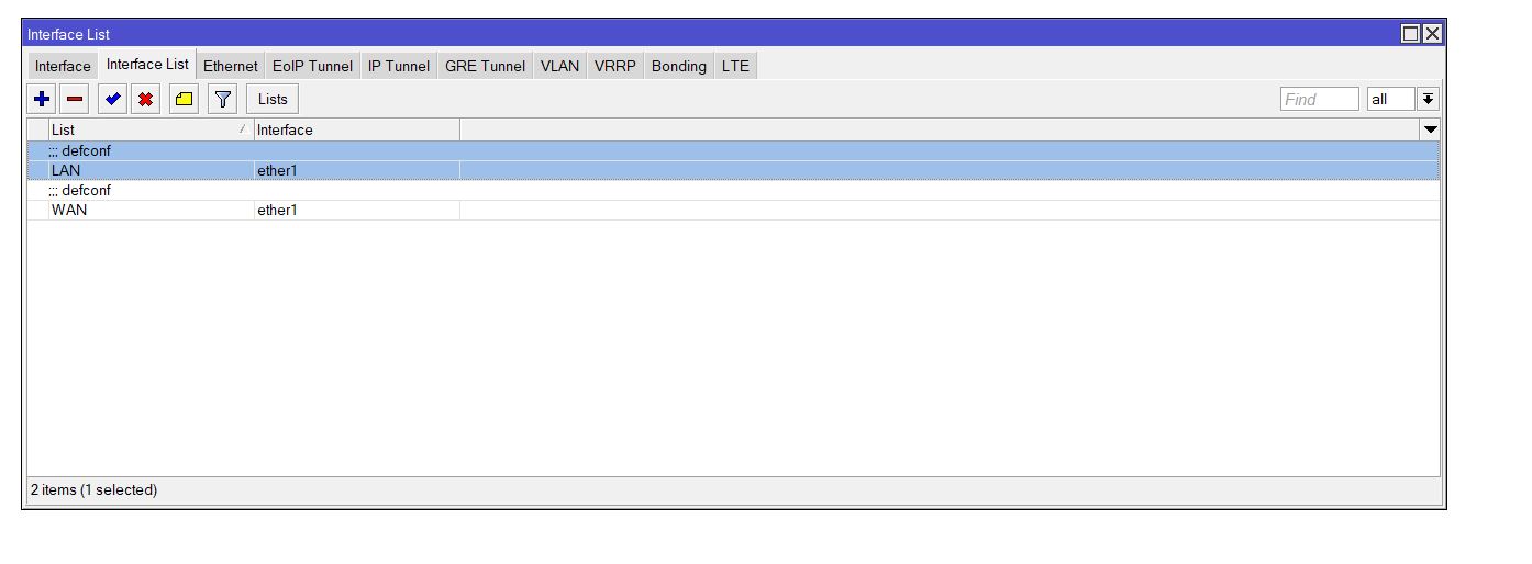

I suppose you need an external DNS Server.
How can your Gateway resolve names like “router.eu.thethings.network” ?!?
Something like
/ip dns static
add address=8.8.8.8 comment=externaldns name=GoogleDNSPrimary
/ip dns static
add address=8.8.4.4 comment=externaldns name=GoogleDNSSecondary
You can choose the DNS Provider as you like.
thanks for your answer, and sorry again but I’m not an expert on network :).
I add in the Ip dns static but it’s still the same
This was my fault…
Static DNS ist not the right command to configure DSN Server.
It is to map a name static to an IP Adress…
As writen in the mikrotik wiki the right command is:
/ip dns set servers=8.8.8.8,8.8.4.4
