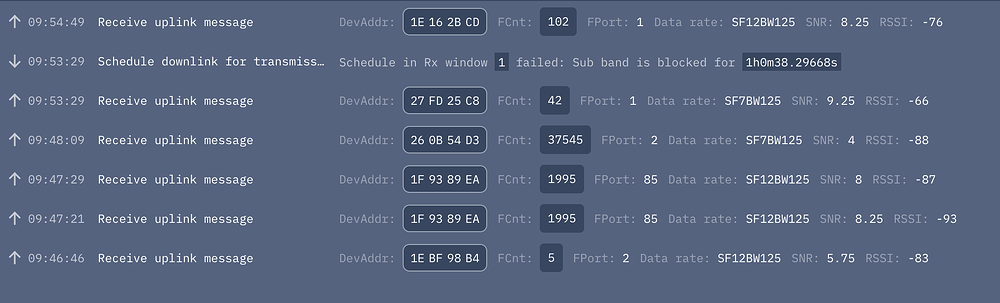

I’ve seen the message “Sub-band is blocked for XXX min” on TTN’s console for two different GWs when no large amount of DL was sent (no specific app DL etc.). The curious thing is that on the TTN’s GW main page it showed 0% usage of duty cycle for all the frequencies. One one GW the network was trying to send DLs after devices joined and they were blocked. I has to disable DutyCycle enforcement for the GW to get things back to normal.

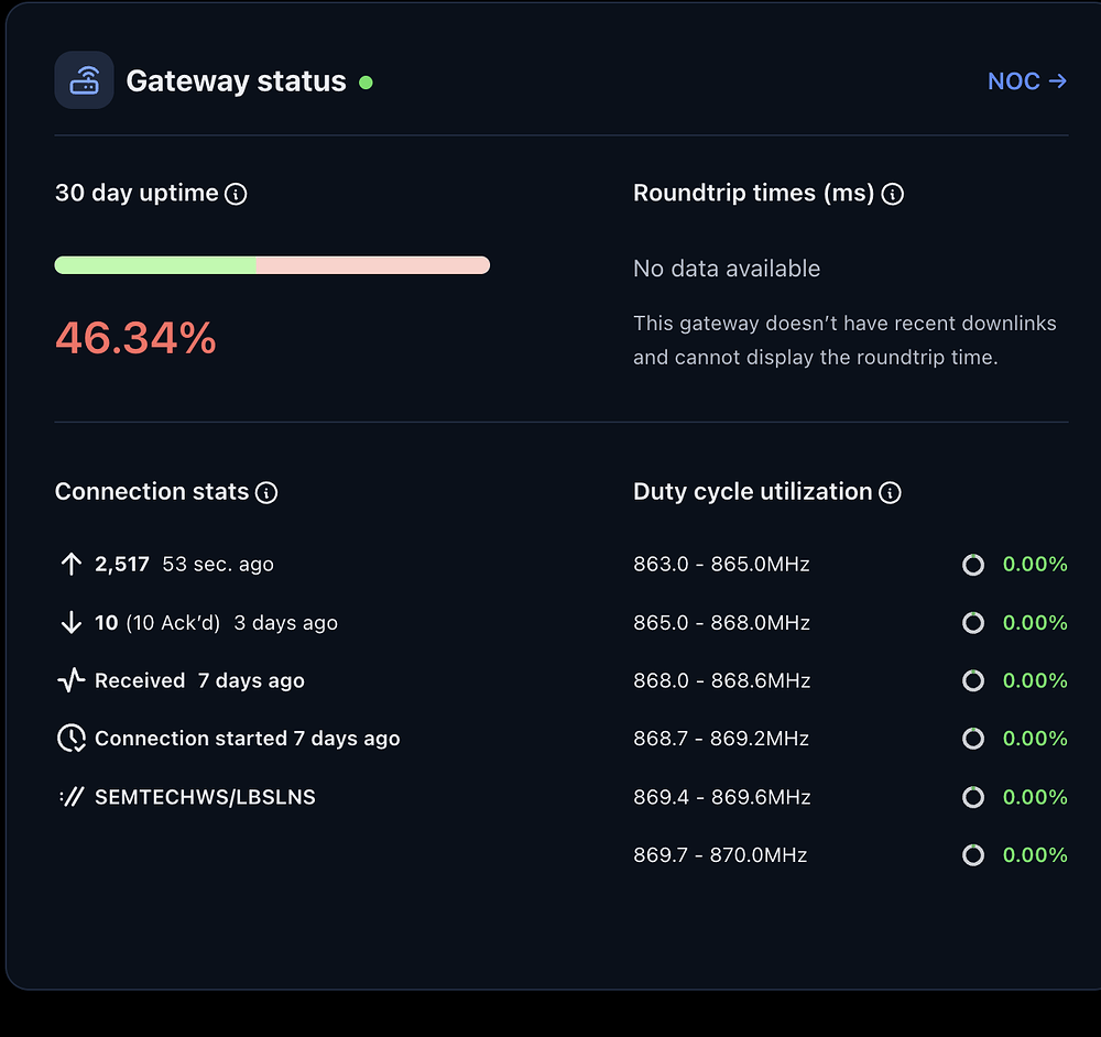

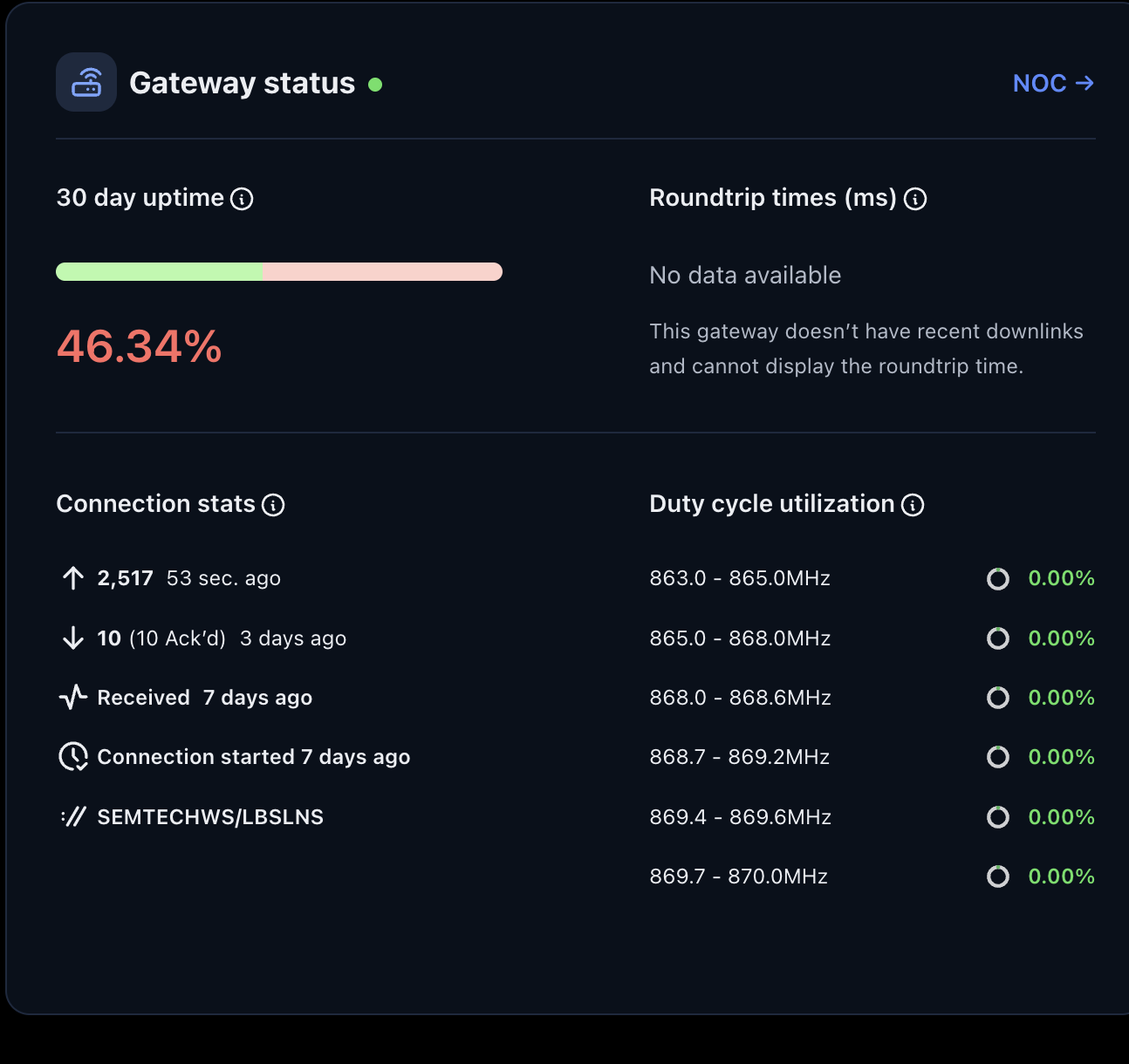

I’m wondering if the GW is not reporting a duty cycle exhaustion which causes the message to be displayed on TTN. I’ve seen that TTN requires a specific implementation for the xtime field that is used for the duty cycle computation. I’ve reported it to Mikrotik and they want me to send logs. Unfortunately I’m fearful to turn duty cycle enforcement again on the impacted GWs since blocking DL causes lots of issues.
The thing is that, if the TTN duty cycle counter show very low % usage as in my case, the only cause of the message might be gateway, that’s my theory …

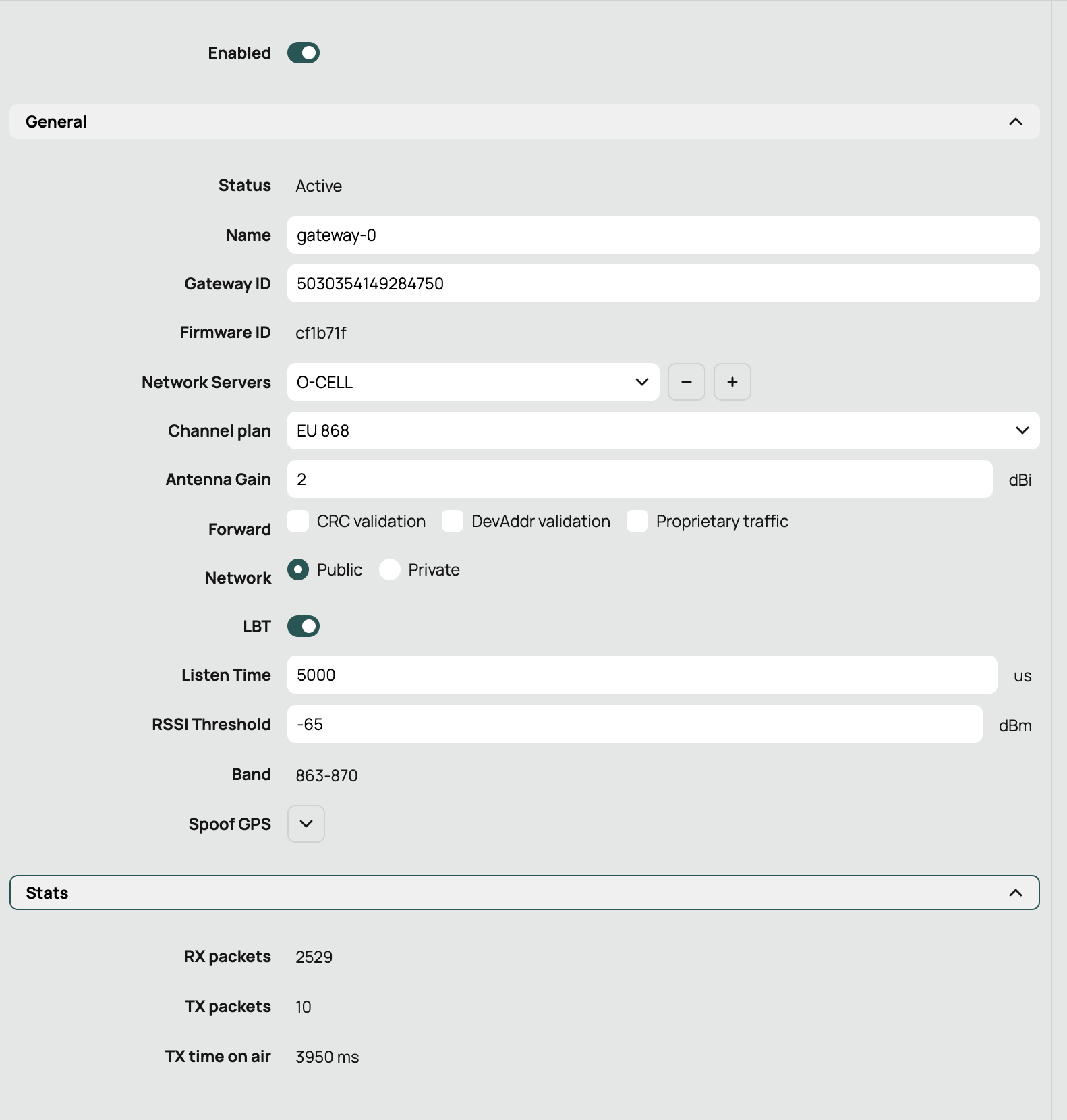

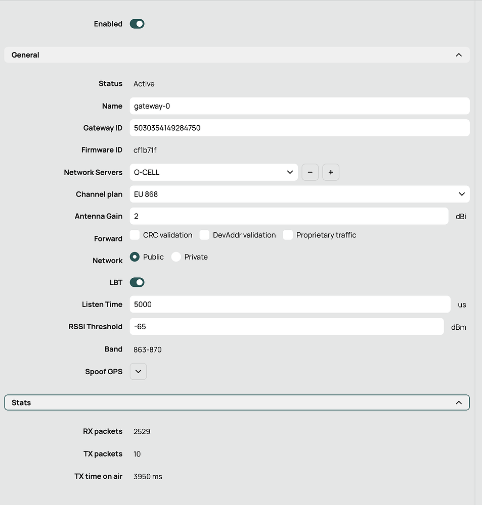

If you check the screenshots I’ve sent on the console panel it show 0% usage on all frequencies and show 10 DL (ACK) 3 days ago. On the GW itself it also show 10 TX paquets for a total airtime of 3.950s . If the packets where sent 3 days ago then the duty cycle shouldn’t be an issue …
