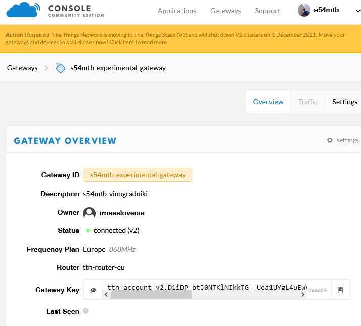

Not working. I have no access to the raspberry pi. It is somehow tunneled to the resin.io and I have no access to the console. Is there any possible option to use raspberry pi with RAK wireless gateway “hat” in the console V3? I can dismount the hardware, replace the SD card with new content. Are there any instructions for “DIY”-ers?
Gateway is connected to V2:

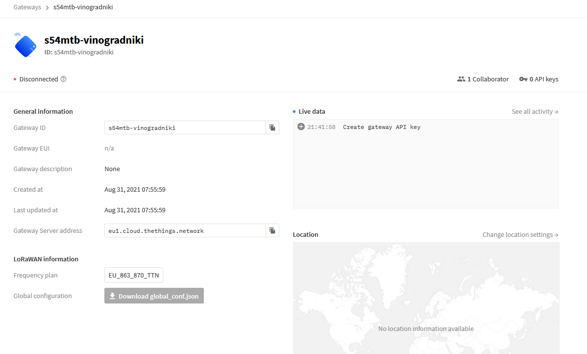

I registered with same name, but I cant enter (copy/paste) gateway key or any other data.
This is newly created GW in V3:
slika
It seems it won’t work that way. Is there any option to reuse the hardware for use with V3 console?
