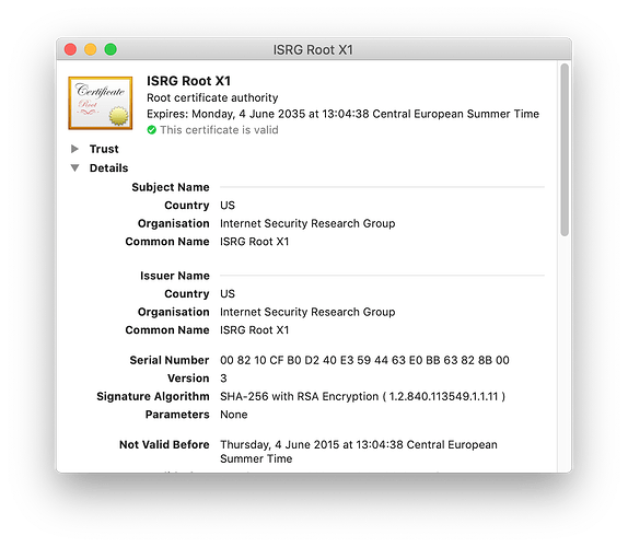

Note that TTN has been using Let’s Encrypt since August 2017, so one might not need to specifically use this PEM file if somehow one’s operating system already trusts that (common these days; search for an ISRG Root certificate) and if the client trusts the roots from the operating system.
(So, it would help to know if the same laptop is used. But well…)
