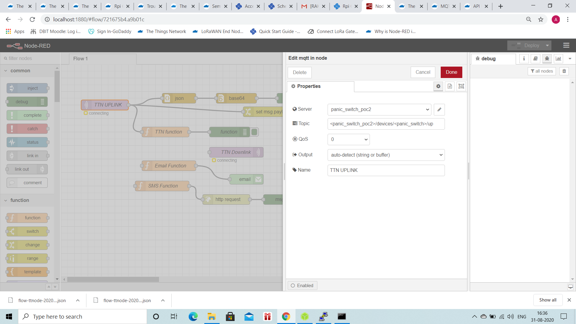

I have to configure, MQTT to receive data in Node-Red
I did all the steps to receive uplink messages as mentioned in the documentation(Without TLS)
I have just started and i cant find where i went wrong.
It says connection failed

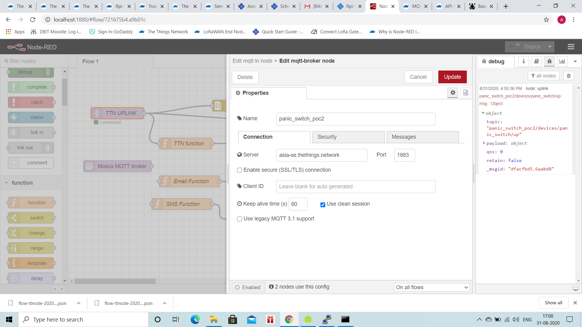

This helps me to overcome the error
Thanks for posting back that you solved it.
Looking at your images it seems you solved this by changing asia.thethings.network to asia-se.things.network. Good, but please don’t let people guess from some image you post. So, next time please describe the problem in the title, and please don’t post images for text, such as for log files (which also includes a lot of unrelated clutter in that screenshot). See How do I format my forum post? [HowTo]

Also, I’m surprised this works:
If you’re not getting messages then you may want to remove the < and > characters. (Also, you could use wildcards, like +/devices/+/up.)
Yes, sorry. I had to remove the < and > at both application ID and device ID places
