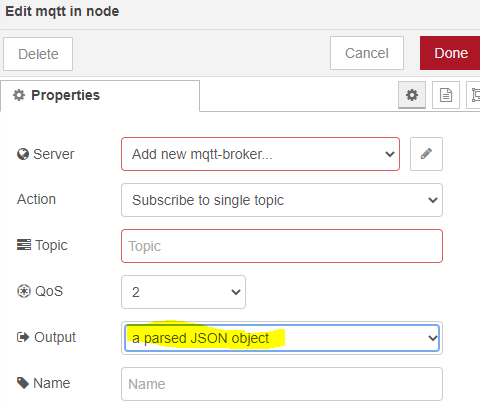

Also set your MQTT node in node-red, then you can eliminate the JSON node.
