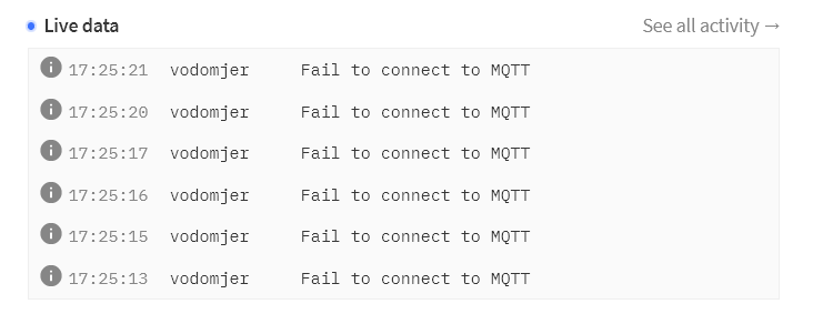

I have just one connection…and live data shows the error:
screen

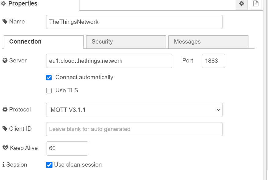

screen2
I don’t suppose I have to use TLS configuration?

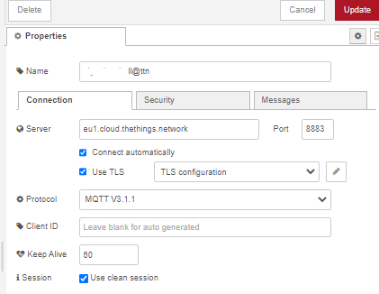

Change the port to 8883 and check the TLS box, let see what happens…,…
:slight_smile: I don’t have TLS certificates…I would have to configure additionally.
Actually, it did connect.
