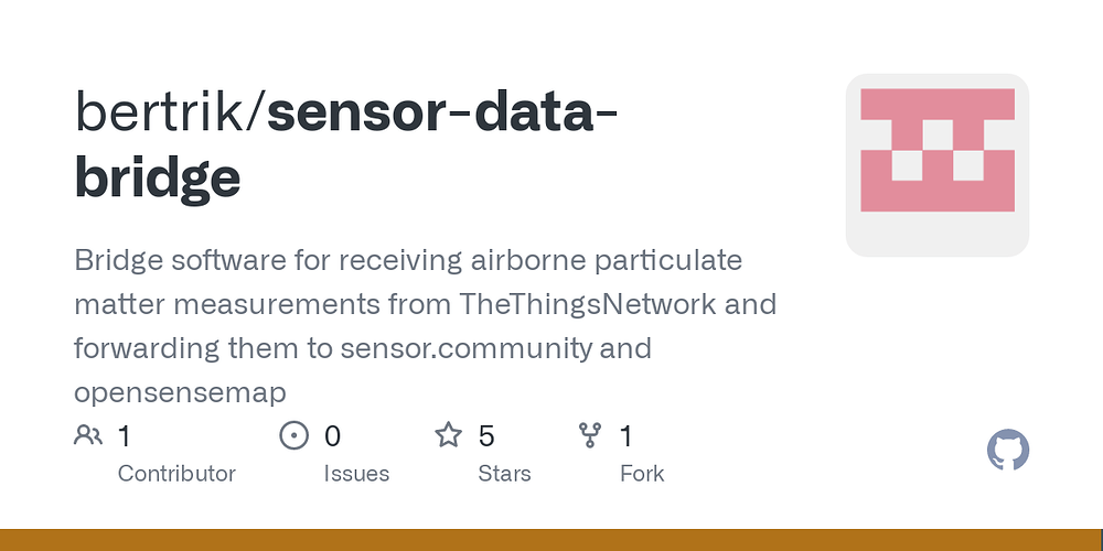

I wrote a forwarder in Java that subscribes to the TTN MQTT uplink topic, decodes the sensor information and forwards it so sensor.community:
This forwarder has been tested to work with the data format from Marcel Meek’s sensor (you do need to configure a payload decoder in the TTN application/device).
I have an instance of this forwarder running already, I can add your sensors too if you want. For this I require the name of the application and a TTN API key with rights to receive MQTT messages from your devices and to read device properties. You can also run this forwarder by yourself too, the docker/ subdirectory contains a docker-compose file.
You need to define a noise sensor at https://devices.sensor.community/ with the right properties (noise sensor) and obtain a unique device id that can then be linked to your device by setting it as a TTN device attribute ‘senscom-id’.

Bertrik,
I asume that MQTT sends its data to al the listeners (at acertain ip-adres) that are registerd to listen to the specified sensor.
I am not in to docker yet so it would be nice if you could add my sensor (just the one in front of my home) to the community.
