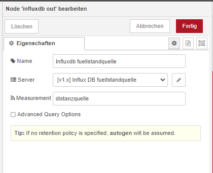

Now I want to write the distant into the databank.

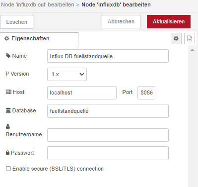

But with the settings in my “influxdb out” node I’m getting an parsing error:
Error: A 400 Bad Request error occurred: {"error":"unable to parse 'distanzquelle
Screenshot (29)
Screenshot (30)
Screenshot (32)

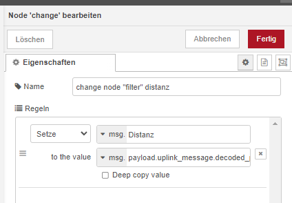

How is your change node set up?
Good morning.
its a basic setting where i just writing the distance into the msg.Distanz.

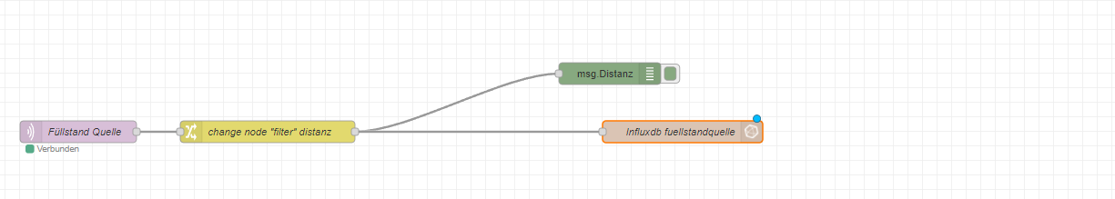

I assume the “influxdb” Node is still getting the whole string?
Thank you very much in advance!

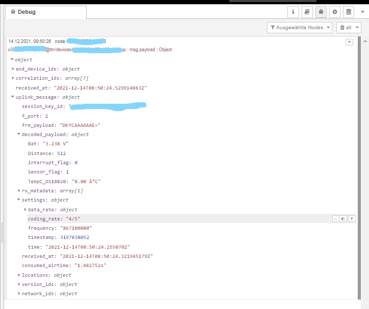

In the screenshot below you can see the payload directly after the “MQTT node” as requested.
Screenshot (36)
As you can see the payload is decoded as a Java object payload and the distance is printed without the mm.
Thank you very much in advance.

Now make sure your change node does it’s job correctly. For the two highlighted fields I will copy and past from the JSON, as typos are easy to be made.
There is a button on the right of the debug window that does this job.

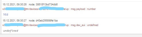

As far as I understand what you want me to know I made to debug nodes. One with the “msg.payload” and one with the “msg.dev_eui”.
is this what you meant?

As you can see I’m having some trouble with the change node or to be more precise with the “dev_eui”.
I configured the change node as I posted in the picture before but I’m getting the message that the “msg.dev_eui” is undefined.
I’m not sure why…
