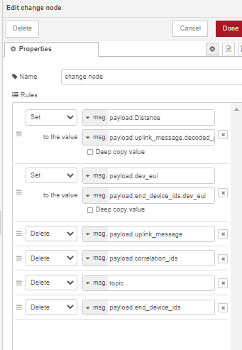

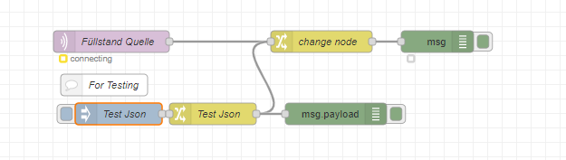

Thats the flow

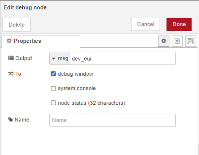

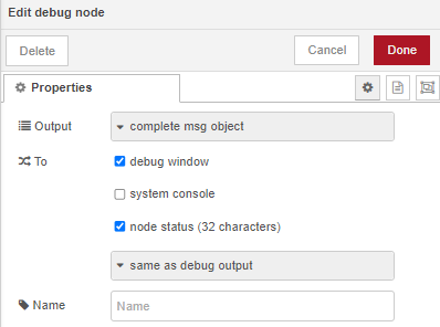

You have added a few thing that aided in the confusion.
You should rather keep your debug node set to as below.
This way you only get part of the JSON
I have corrected your flow, you will see there is a “Test Json”, if I hade you JSON I could have solved the problem faster.
You should be good now to inject the JSON into the Influx DB node and have the correct data in the DB.

Thank you very much!
I like the solution and I’m very thankful for your very useful tips!
I also like the testing via the inject node. I did not know this trick… I just waited for the next payload from the LoraNode.

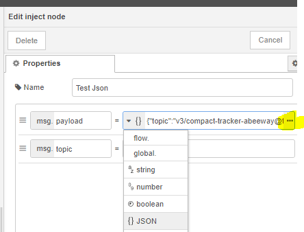

dwJ9uLCIM0
and past in inject node, press the … and delete what ever is in the window and past your JSON, hit “Done”, Done" and “Deploy”
Now you can inject your JSON into the flow.

Look at this flow.
        "id": "153ff67d1f2c61b8",
        "type": "tab",
        "label": "Flow 2sddsdvv",
        "disabled": false,
        "info": "",
        "env": []

        "id": "60f39d916a35dd8b",
        "type": "inject",
        "z": "153ff67d1f2c61b8",
        "name": "Test Json",
        "props": [
                "p": "payload"
                "p": "topic",
                "vt": "str"
        "repeat": "",
        "crontab": "",
        "once": false,
        "onceDelay": 0.1,
        "topic": "",
        "payload": "{\"topic\":\"v3/compact-tracker-abeeway@ttn/devices/eui-20635f0161000093/up\",\"payload\":{\"end_device_ids\":{\"device_id\":\"eui-dhdfth\",\"application_ids\":{\"application_id\":\"fjdjdy\"},\"dev_eui\":\"hth3\",\"join_eui\":\"hrhxf\",\"dev_addr\":\"hhF\"},\"correlation_ids\":[\"as:up:01FPZ2ZC6PJQE0XQ68ECN239B7\",\"gs:conn:01FNXTS68EYM139F0J53QR5ZK0\",\"gs:up:host:01FNXTS699E4A2H7VSP45SZG62\",\"gs:uplink:01FPZ2ZC04E8WTWP10DHJX97S6\",\"ns:uplink:01FPZ2ZC0568ACBK2MBZQK4148\",\"rpc:/ttn.lorawan.v3.GsNs/HandleUplink:01FPZ2ZC052XX7N17EDTRCYW6D\",\"rpc:/ttn.lorawan.v3.NsAs/HandleUplink:01FPZ2ZC6MRZ4WAM86KEJC7J6B\"],\"received_at\":\"2021-12-15T13:02:16.279389076Z\",\"uplink_message\":{\"session_key_id\":\"AX23nQJEOCVpz1fId9ugRw==\",\"f_port\":18,\"f_cnt\":182,\"frm_payload\":\"BSBhigAQAgAAAwIA\",\"decoded_payload\":{\"ack\":0,\"batteryPersentage\":97,\"bleFirmware\":\"bleFwVersion3.2.0\",\"data\":0,\"Distance\":512,\"debug\":{\"length\":12,\"payload\":\"0520618a0010gfhfg030200\",\"port\":18,\"server_time\":\"2021-12-15T13:02:16.283Z\"},\"lastResetCause\":\"lastResetCause: 16\",\"mcuFirmware\":\"fwVersion: 2.0.0\",\"status\":{\"mode\":{\"code\":1,\"description\":\"Motion tracking\"},\"moving\":false,\"on_demand\":false,\"periodic\":false,\"sos\":false,\"tracking\":false},\"temperature\":25.81,\"type\":\"HEARTBEAT\"},\"rx_metadata\":[{\"gateway_ids\":{\"gateway_id\":\"dhdth-mdhdfhfn-01-dbn\",\"eui\":\"3dhdfhdfgh0\"},\"time\":\"2021-12-15T13:02:15.958012Z\",\"timestamp\":534735231,\"rssi\":-109,\"channel_rssi\":-109,\"snr\":1.75,\"location\":{\"latitude\":-505059.885050571,\"longitude\":5050.905081617,\"altitude\":225,\"source\":\"SOURCE_REGISTRY\"},\"uplink_token\":\"CiIKIAoUdGVjaDUtbWFsdmVybi0wMS1kYm4SCDQ2MjgkAFAAEP/S/f4BGgsI2M7njQYQ1+/aICCYsNCFyP3/ASoMCNfO540GEOC06MgD\",\"channel_index\":4}],\"settings\":{\"data_rate\":{\"lora\":{\"bandwidth\":125000,\"spreading_factor\":7}},\"coding_rate\":\"4/5\",\"frequency\":\"867300000\",\"timestamp\":534735231,\"time\":\"2021-12-15T13:02:15.958012Z\"},\"received_at\":\"2021-12-15T13:02:16.069864716Z\",\"consumed_airtime\":\"0.061696s\",\"locations\":{\"frm-payload\":{\"latitude\":-29.8889728,\"longitude\":30.916608,\"source\":\"SOURCE_GPS\"}},\"network_ids\":{\"net_id\":\"000013\",\"tenant_id\":\"ttn\",\"cluster_id\":\"ttn-eu1\"}}},\"qos\":0,\"retain\":false,\"_msgid\":\"d38de075552048d0\"}",
        "payloadType": "json",
        "x": 230,
        "y": 360,
        "wires": [
                "99997bbb40d80fb0"

Well, when I’m looking at the two rows of code I’m feeling stupid.. :smiley:
Thank you for showing me this solution.
Then there is only the problem with the DB left..
I’m very confused about the error.
I don’t mean the problem with the retention of the data..
I am here to learn, there are no stupid questions.
Try that flow, I had to brush up on Influxdb, not my 1st choice for a DB.

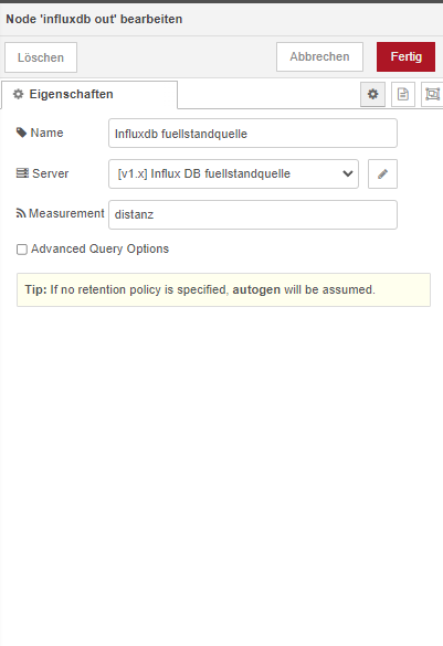

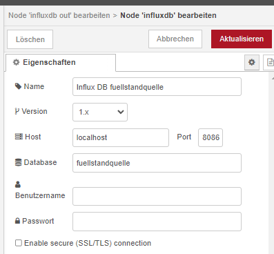

Yes, that’s true but sometimes I’m feeling stupid. even if I’m learning a lot of things by trying things iv never done before…
Error: A 400 Bad Request error occurred: {"error":"unable to parse 'distanz Distance=510,Füllmenge=4159.7452,dev_eui=\"\",end_device_ids=[object Object],received_at=\"2021-12-15T20:10:26.405479754Z\"': invalid boolean"}
There’s still the same error with the DB…
I would say that’s a problem with the “Measurement” in the DB Node
Because we did not delete ‘msg.payload.end_device_ids’ from the JSON
        "id": "059296a9a604036f",
        "type": "change",
        "z": "454b7c0d2cc14647",
        "name": "change node",
        "rules": [
                "t": "set",
                "p": "payload.Distance",
                "pt": "msg",
                "to": "payload.uplink_message.decoded_payload.Distance",
                "tot": "msg"
                "t": "set",
                "p": "payload.dev_eui",
                "pt": "msg",
                "to": "payload.end_device_ids.dev_eui",
                "tot": "msg"
                "t": "delete",
                "p": "payload.uplink_message",
                "pt": "msg"
                "t": "delete",
                "p": "payload.correlation_ids",
                "pt": "msg"
                "t": "delete",
                "p": "topic",
                "pt": "msg"
                "t": "delete",
                "p": "payload.end_device_ids",
                "pt": "msg"

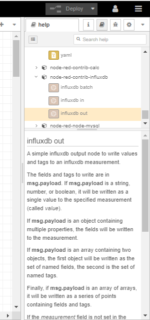

Yes, you are completely right. The only thing I don’t like is that now I’m saving “Füllmenge” values like this: “4157.4213199999995”. I need to fix this in the next step.
Why does this message make this problem?
I need to understand what I’m able to save and what doing errors are like this.

        "console": false,
        "tostatus": true,
        "complete": "true",
        "targetType": "full",
        "statusVal": "payload",
        "statusType": "auto",

Yes, Influx needs the measurements as msg.payload.temp, msg.payload.hum, you are omitting the payload part.
Read the help
