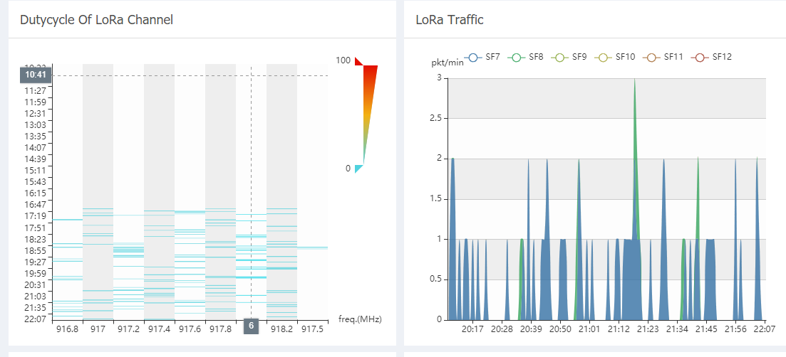

(Mrpackethead) #8
Im not yet seeing large scale congestion, There is however other thigns operating in the AU915 sub-band 02 space… My gateway is seeing several packets per minute that are not TTN.
Capture
(Tony Smith) #9
For the gateway to decode the signal I assume it must be a LoraWan packet, probably from another LoraWan system, ie not a TTN system, most likely LoraServer.io. The other users of the ISM band should not result in an output from the gateway.
To help people set up LoraServer.io systems outside of Block2 I contributed to its development and created the ability to commission that system on other blocks. Otherwise Block 2 would become congested by being the default for everyone.
