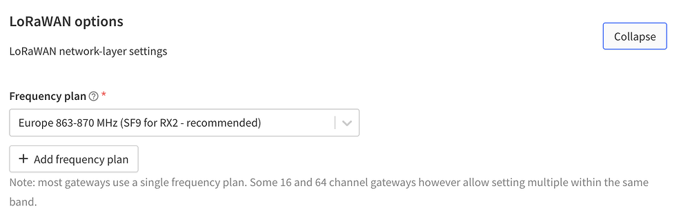

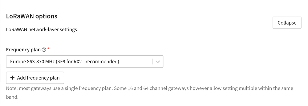

Yes this is possible.
In the Console, use the Add frequency plan button to set a second frequency plan for your gateway in the gateway’s General Settings page.
Once you’ve set this, you can reconnect the gateway and the LNS will send the updated router_config message for two concentrators.
