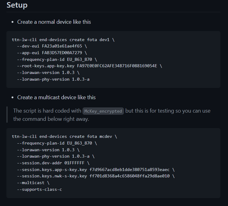

The example in the fuota server is using this setup:
But it is not mentioned what key’s I have to set for the mac 1.1.0 verion in the se-identity.h file of the LoRaMac-node stack.
Reading the specifications from the LoRa Alliance didn’t help…
It would be awesome if someone could provide waht steps on the node and what steps on the server have to be done, to communicate over the virtual multicast device.
