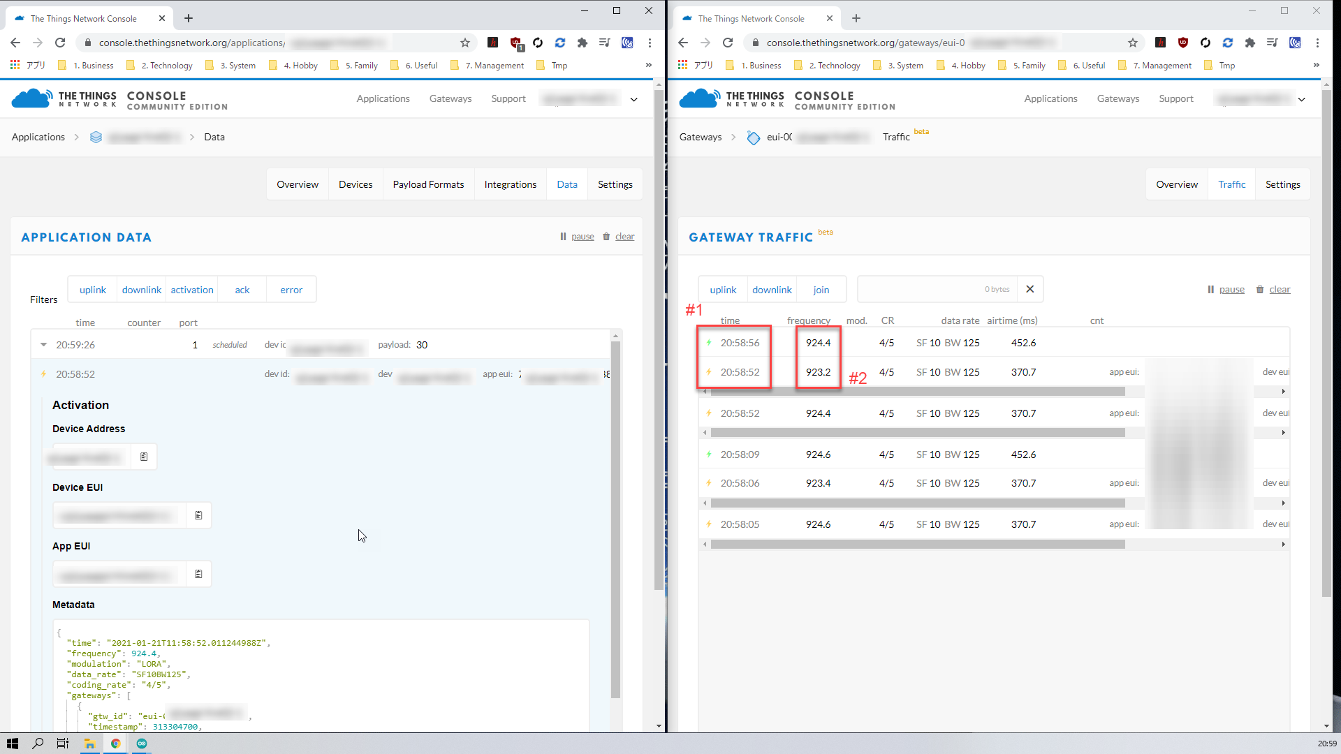

Today I realized my Conduit does NOT respond to Join Request within RX1/RX2 time.
When OTAA Joining fails Conduit does NOT respond within above 1s after receiving Join Request. When OTAA succeeds Conduit does respond.
Here is a screenshot from my TTN console.
These are the problems I found.
(1)In #1 Jon Request is received by GW at 20:58:52. But Jon Accept was sent from GW at 20:58:56. It takes 4s. Can not respond within RX1/RX2.
(2)In #2 why does the GW respond with 924.4MHz frequency? According to LoRaWAN™ 1.0.3 Specification, section 3.3.1, the first receive window RX1 uses a frequency that is a function of the uplink frequency and a data rate that is a function of the data rate used for the uplink. I’m not sure 924.4MHz in Join Accept is OK or not. Please tell me.
When OTAA succeeds Join Accept is sent from the GW immediately after Join Request with the same frequency as the frequency of Join Request.
It seems to be strange.

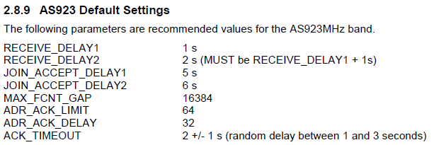

Except RX1/RX2 is for downlinks, if you look at your first screen shot above, you’ll see the join delay is 5s and 6s - presumably this will be sent in the second window when the gateway gets it.
Your picture shows your node seemingly transmitting pairs of join requests at different frequencies impossibly close in time.
The 924.4 MHz responses are legitimate responses to one of those, but you’re getting confused because you are looking at the other copy on a different frequency.
Now of course, what is actually happening is not the node transmitting twice. Rather, your node is too close to your gateway causing it to be overloaded and bleedover into additional fictitious signals on channels it did not actually transmit on.
Move your node further away from the gateway, and make sure that the log is only showing one join attempt or uplink with a given timestamp, not two.
