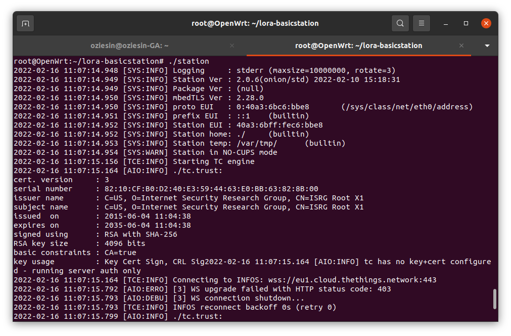

I coppied all files to my device and i run .station and i faced screen below
basic
How could i fix this and connect my gateway to TTN server ?
