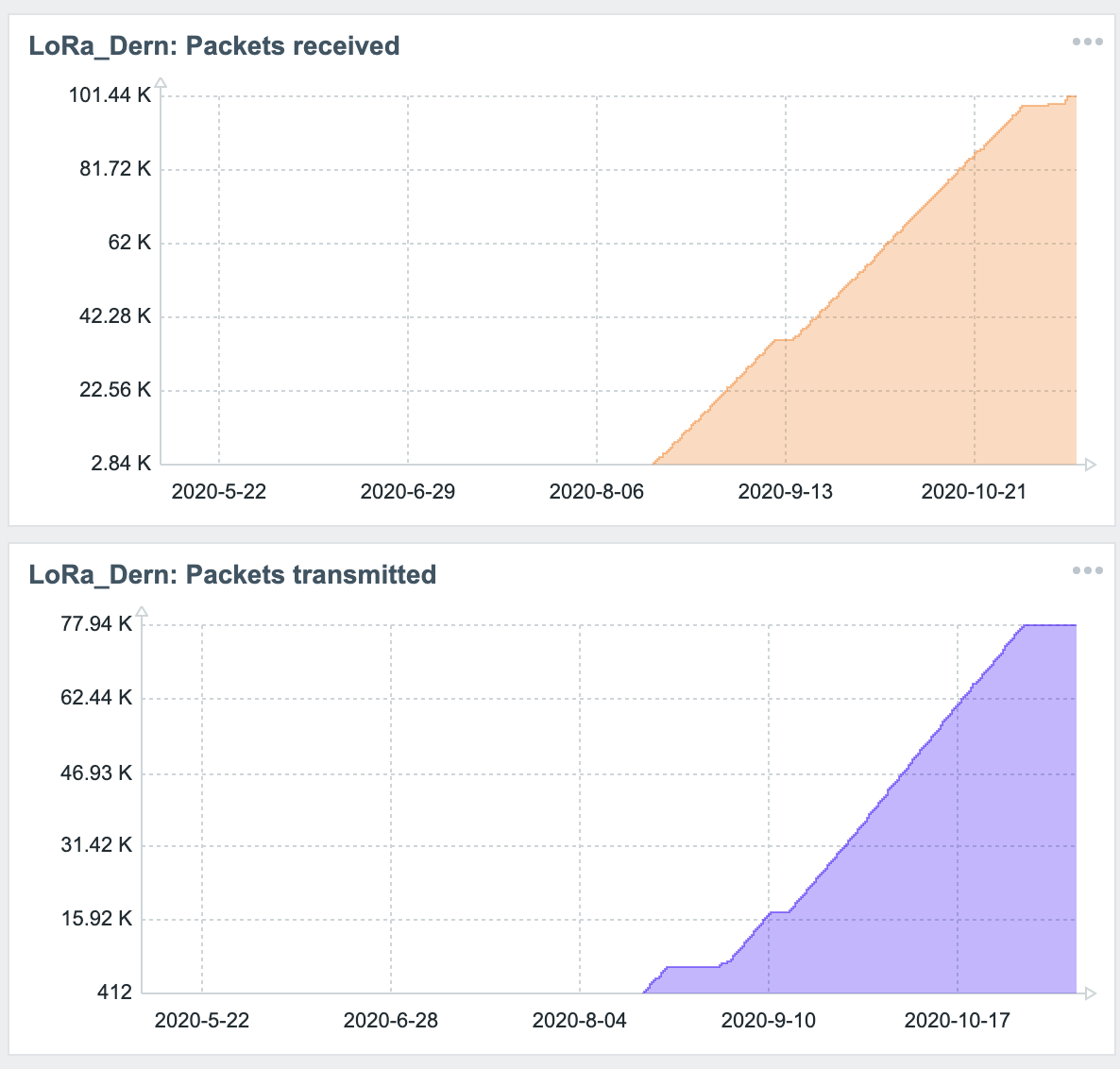

Funny (and fun) watching the traffic. In contrast to yours, my traffic dropped off pretty quickly at the end of October for no discernible reason. (I noticed it would plateau for a while after a reboot or update, but this seems to have fully flattened it.)
Screenshot 2020-11-10 at 09.56.08
(ā€˜Fully flattened’ is a bit of an exaggeration - it’s just dropped to a <100 packets a day now.)
Hi Ryan,
How did you get the data to compile these graphs? Or are you making daily notes and put them in a sheet?
/rw

Heya. I have a Zabbix setup at home for monitoring various RPi-based services. I use a small Python script to grab the latest numbers from the gateway’s page every minute or so and pop them into the host’s dataset. It’s a terrible, no-good solution for a lot of reasons but it solved my immediate need of being able to broadly see if traffic was moving.
