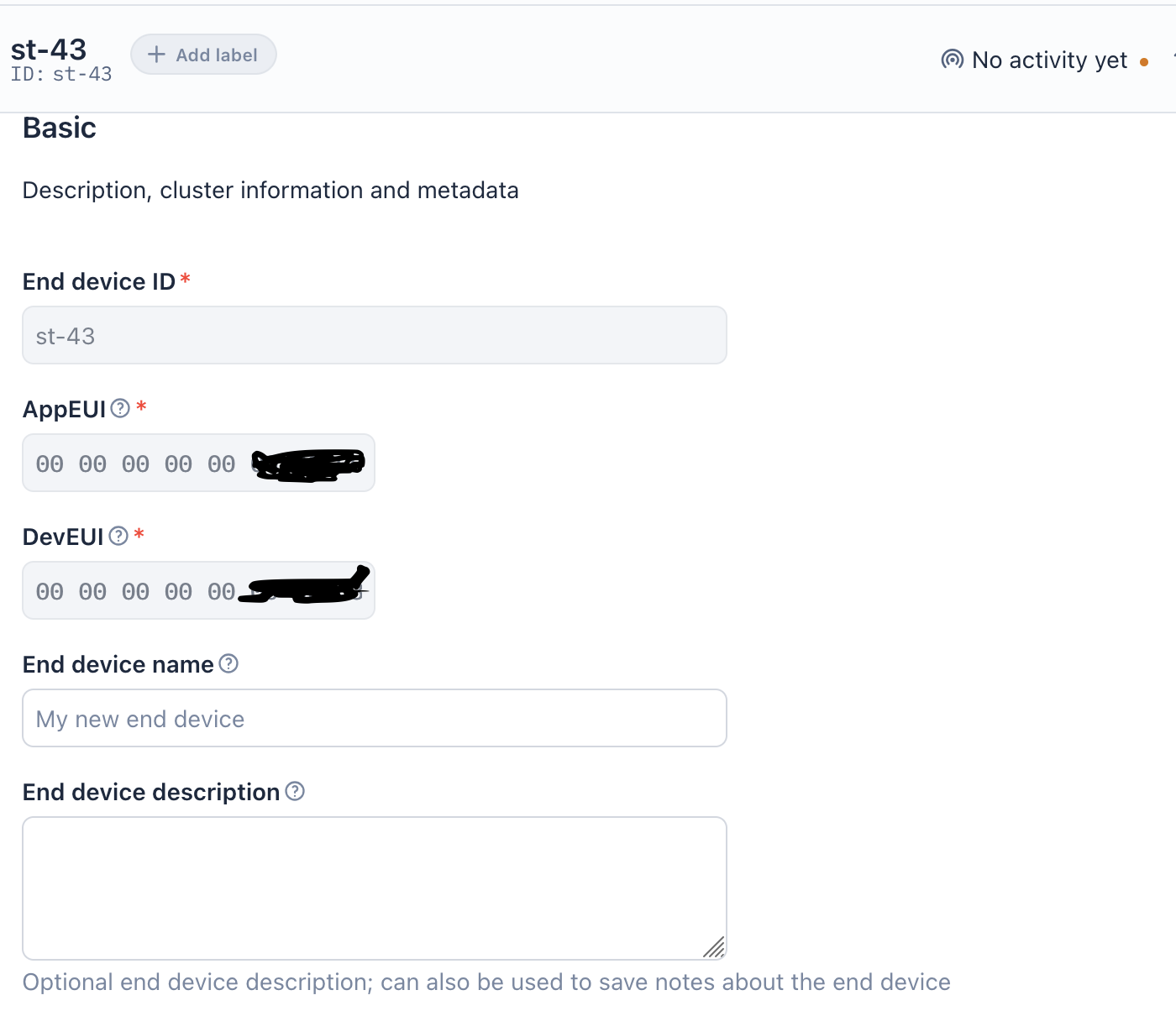

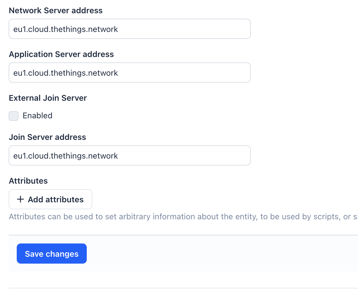

I edited the devise st43 and here are the settings:
Let say, that the AppEUI is with all zero
Let say that the DevEUI end with 43 43 43

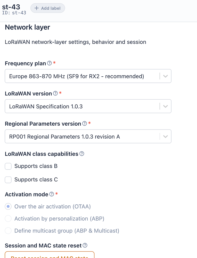

While I create the new devise, I observed the latest LoRaWAN version is 1.1.0 but I kept as I did some year ago. Is may a problem?

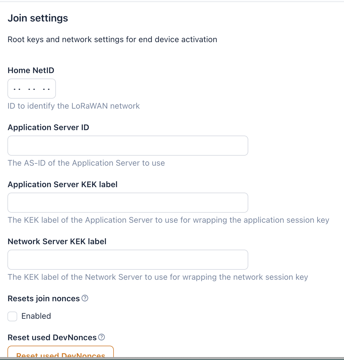

Regarding the Join Setting, I leaft all empty excepted for the AppKey

/ This EUI must be in little-endian format,
  static const u1_t PROGMEM APPEUI[8] = { 0x00, 0x00, 0x00, 0x00, 0x00, 0x00, 0x00, 0x00 };
  // This should also be in little endian format, see above.
  static const u1_t PROGMEM DEVEUI[8] = { 0x43, 0x43, 0x43, 0x00, 0x00, 0x00, 0x00, 0x00 };
