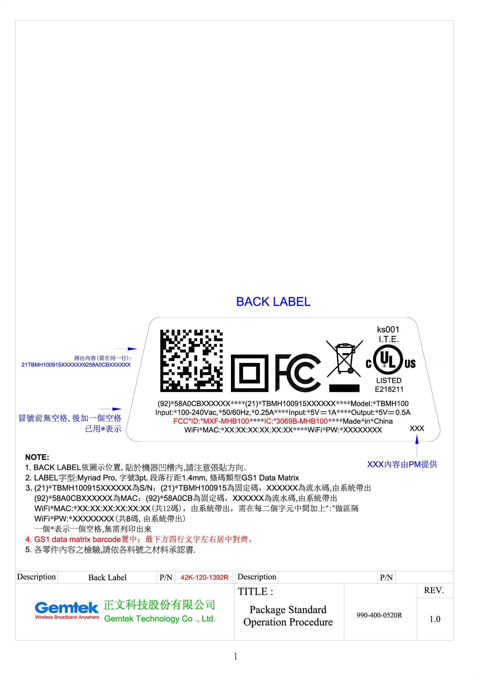

Here we have the FCC documents for the “Mini Tabs MHB100”
