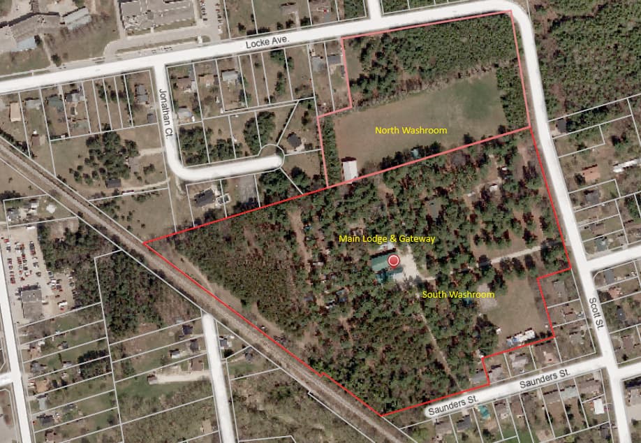

First I wish to thank you for your comments, they were very helpful. Now for more information - A google map link to Stayner Camp - Google Maps
I am also adding a older picture of the camp that has less tree coverage to show you distances. Everything in Red Outline is the camp. I have a Unifi Wi-Fi Network covering approx 85% of camp. Thanks for any assistance.
Steve Fulton, UE
Short answer, stick to a small MCU at each location that detects the request and sends the SMS request over the WiFi.
Or, as I said above, look at what else you can do with LW to make it worth the extra effort.
