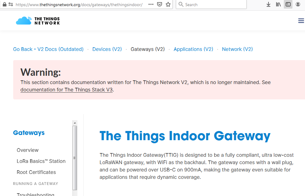

Any links taking you to V2 docs will, in the main, on thethingsnetwork.org sites, also have a warning to say they are deprecated and relate to V2 only and include a link to where you can find V3 docs etc. e.g.

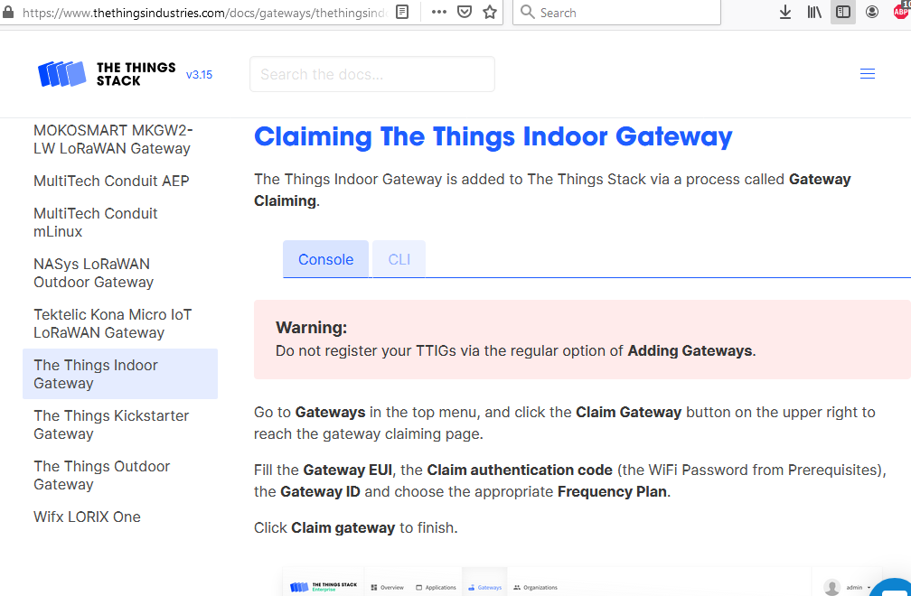

Here the section on the TTIG down the body of the page - or linked from the useful listing of common/popular GW’s often used on TTS/TTN down the left side takes you to the current official info where it clearly and unambiguously shows:
Note also the warning about not using regular ‘adding’ option

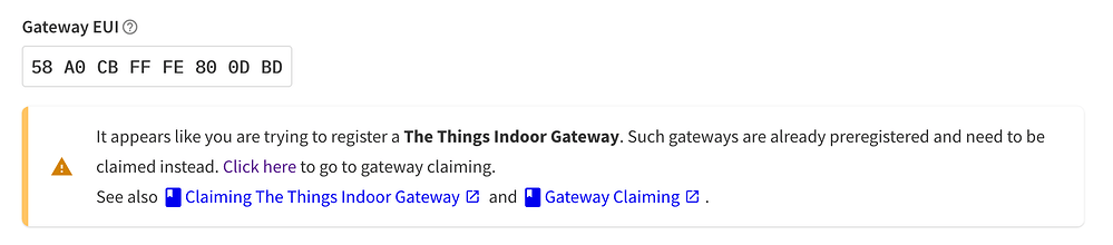

The Mods/volunteers have already asked TTI Core for steps to be taken to hide from Google et al such as this, whilst also seeking to preserve info for those who need it. There are lots of warnings and banners already in place - but sadly users often just work around or ignore. Such as when adding a TTIG:
