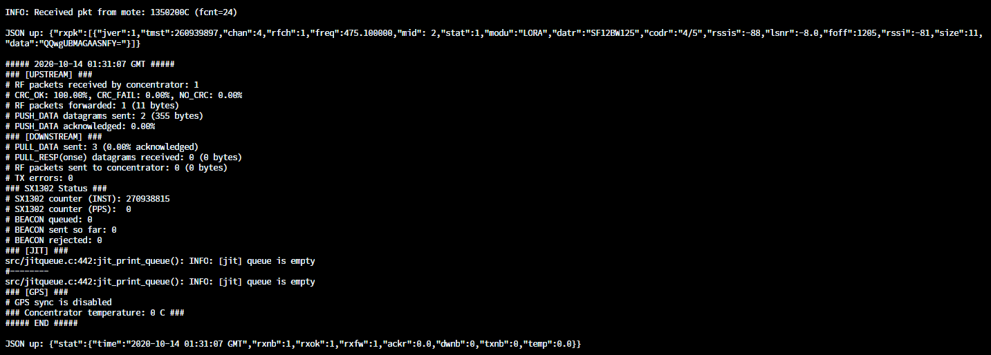

PUSH_DATA acknowledged: 0.00%
PULL_DATA sent: 3 (0.00% acknowledged)
I don’t know why I can’t get any ack confirmation every time I run the code lora_pkt_fwd.

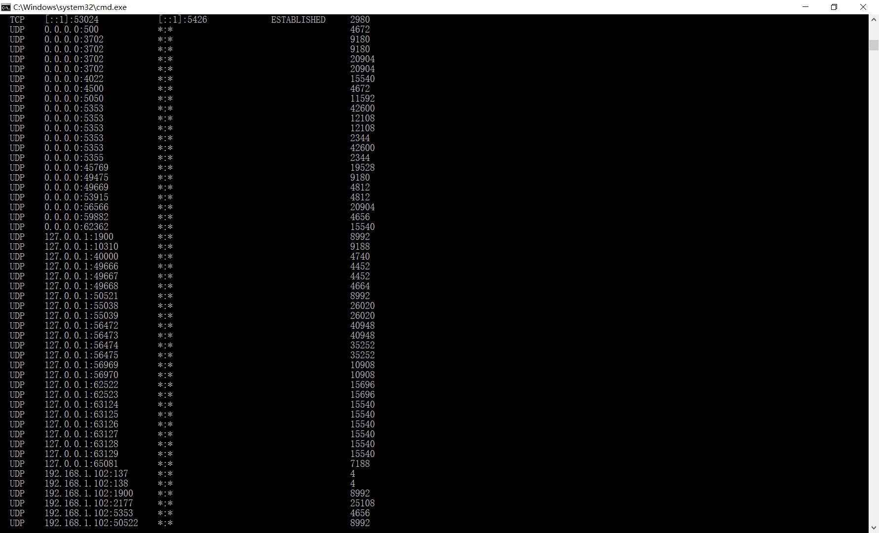

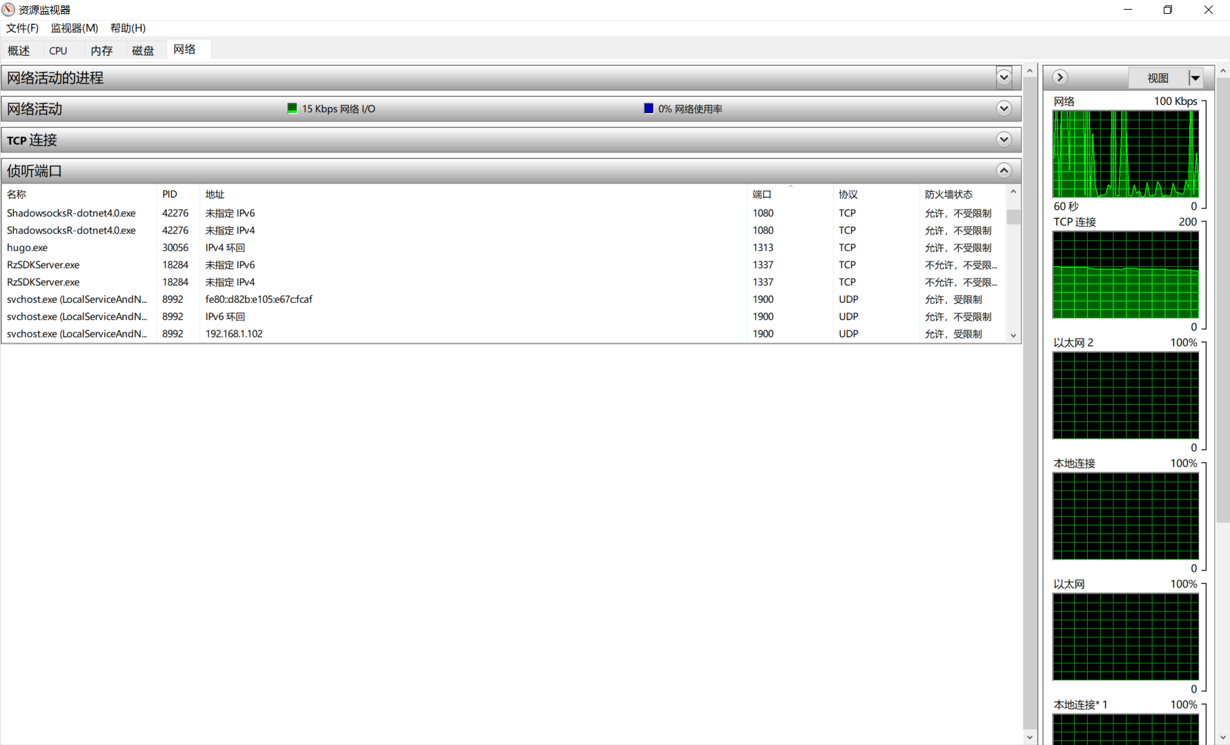

When I run the script, I don’t even see that port 1700 is occupied. Does this mean that the port is blocked by the firewall, or what’s wrong with the operation?
Port 1700 is the remote side, not your local system. Your packet forwarder connects to TTN on port 1700 udp.

You’re looking on your windows machine, not your gateway.
Also 1700 is the outbound port so you wouldn’t really see it in Linux netstat either.
