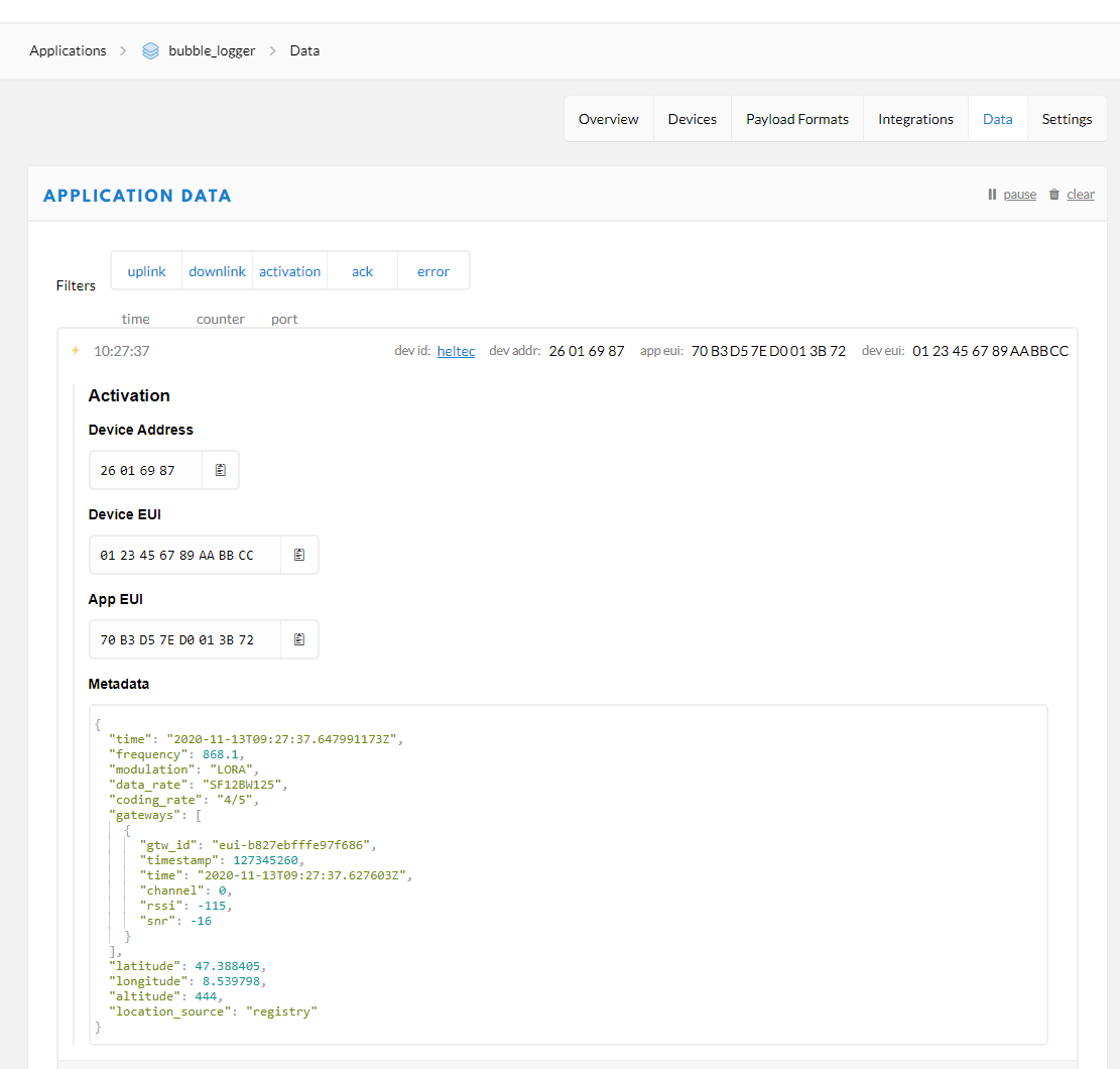

Hello since yesterday I do not get any data. Only this activation
The sensor was running for years. I’m not sure what the message means. How could I find out why it is not sending data? Has the joining failed?
Any support welcome.
Sergio

How often does this device perform the join? Perhaps it ran out of unique join attempts?
Does the network send a join accept?
What software runs on the node?
Signal also appears a little low at rssi -115 and snr -16. Perhaps the node is not receiving the join accept (if any is sent).

Sorry my english is not the best. I’m happy with any suggestions. I moved the sensor to another location and it is joining in about 7 to 10 minutes. It is a heltec LoRa. The Framecount was around 6000 not very high. I don’t have an own gateway nearby. The last activate message was from a gateway at the university in Zürich. Where can I find information about unique join attemps?
I installed lmic with arduino. And yes the signal is quite low there were I use the sensor. Maybe it is just the bad rssi, but usually it worked there as well maybe a near by gateway is out of order. I have another ttgo which had allready this PAX counter installed. This one joins in less then a minute on the same location.
