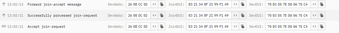

Hello, I am very doubtful right now, I am sending data with LoRaWAN, Heltec ESP v3, via TTN Gateway, but it only comes that it join. I want to send data from DHT11 and from a load cell. below is my code and below is the payload decorder. Can someone please help? Thank you
I have also read through the topics and the only thing I have found is that the gateway is far away from me, but this is not the case with me (I think, but I have entered the nearest gateway in my city). if I am wrong pls send a link from the topic and sorry for opening a new one :slight_smile:
that’s the only thing i get:

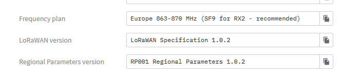

What LoRaWAN version are your sketch using and what did you set it what did you set it on when you registered your node?

Down on the RSSI and up on the SNR, but somewhat irrelevant, does it blend hear the join accept?
everything is the same with the join

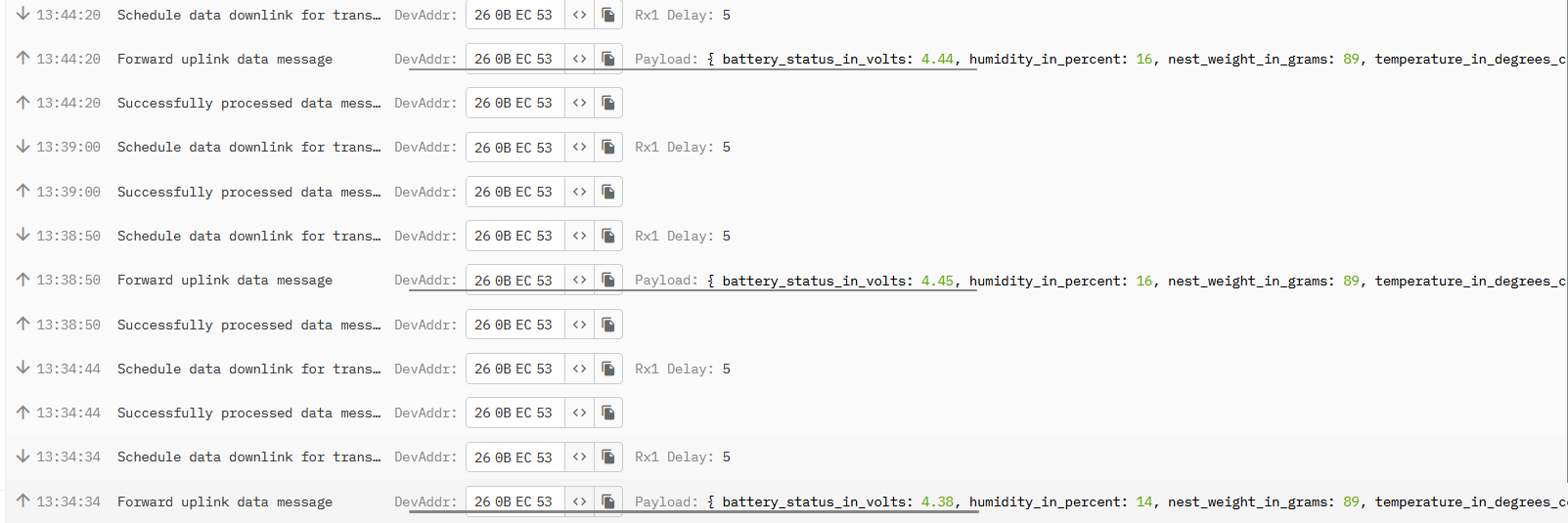

So, I think I’ve got it right. The problem was that the gateway I had was on the hill and the signals didn’t reach it properly. I now have another one that is “flat” or on the same level as my LoRaWAN and now it works.
