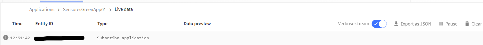

with this code I get the following message from TTN
but nothing more than this. I would like to know how to get the payload. Thanks for your contributions.
The subscribe message means the mqtt session is established.
