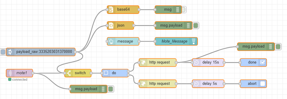

I’ve created a new device in V3, see live data and use Mqtt integration.The username and generated API was copied to the standard mqtt node and the node is connected…but I don’t see messages?

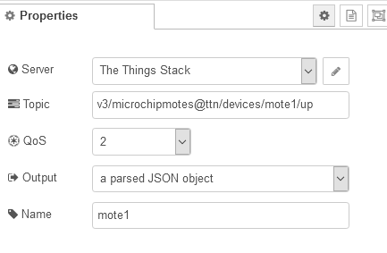

try topic v3/+/devices/+/up
maybe a typo in either the application or device naming

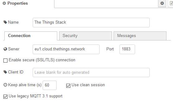

Mine here had Enable secure (SSL/TLS) connection and the port 8883 but it cant be that, if you open up all topic msgs then at least you can start to narrow it down and you know MQTT is working
Thank you, must be a typo
… your topic line does indeed work ![]()
EDIT: More than a typo
: it is v3/application id@ttn/devices/device id/up and not device name
