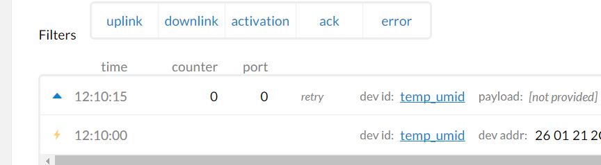

I have added to TTN RS1XX Laird sensor
It send message. But no payload. See attached image.
Any hints?
I’m new with Lorawan. Thanks for patience

The documentation states you need to deploy a ‘server’ that sends a downlink to the device when the first (empty) uplink packet is received. (Downlink should contain time stamp in a certain format)
The node-red example provided in the documentation will provide the required functionality.
However the firmware for these devices uses confirmed uplink for every transmission, if you do not set the interval to very infrequent uplinks you will be breaching the TTN fair access policy which allows for maximum of 10 confirmed uplinks per day. (Equals ten transmissions a day)
The confirmed uplinks are an issue anyway (even when ignoring the TTN fair access policy) because of scalability issues, it drastically reduces the number of nodes a gateway can support.
Dear Kersig
Thanks for Your support
Now it’s clear. We set the interval to 4000 second to avoid problem

Grab latest Sentrius Sensor app from the Google App Store & connect to the device over Bluetooth…push button on front panel…then follow your nose wrt settings in the app menus & info pages, esp look at doing device f/w update as old stocks may not be programmes with all the latest options & features. Suggest use Cayenne LPP payload profile (as Laird protocol expects to see a time stamp as part of Join exercise before it will send data…may require a Node Red set up…search forum!), unconfirmed data, select type of battery you have installed, sample update rate (in seconds). - use anything less than 5-10 mins (600) with caution due to duty cycles & fair use policies of the network your using (search!) as well a life of battery. I tend to go for 15 or 30 min updates (longer if none critical application), actual batt life & compliance may vary, not least with the SF you manage to join with.
