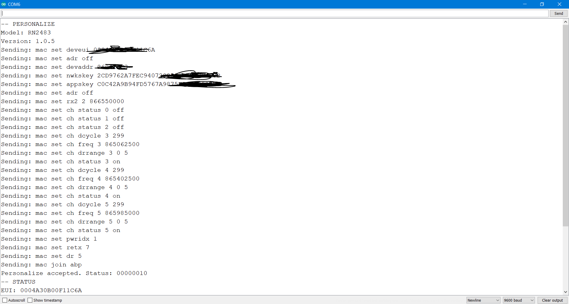

This made the program work and I was able to get the output on the device page. But I tried the same for Indian frequency by changing TTN_FP_EU868 to TTN_FP_IN865_867 and then things dint work.
However, the serial monitor shows everything to be working fine
So I believe this has something to do with my gateway (Liard RG186). So Maybe I should start a separate thread for that
