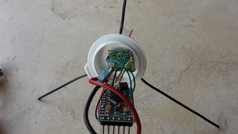

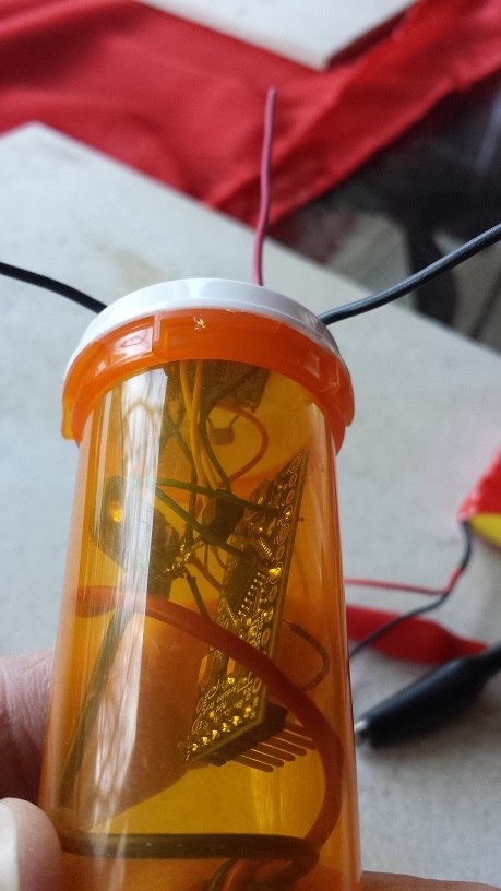

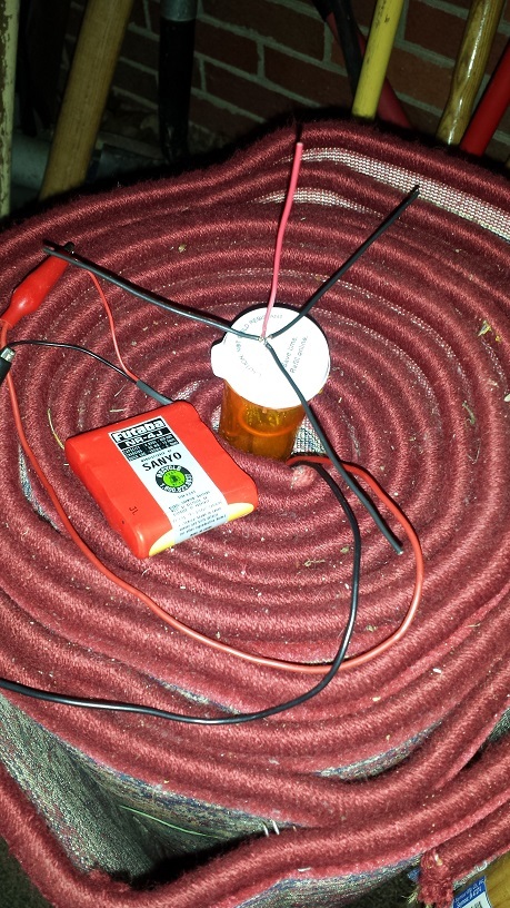

Just got a node working with a short node.js script to read the data from the mqtt queue and save it in a mongodb collection. Pics of the dead bug analog temp sensor, an arduino pro-mini (which LMiC TTN demo fills to 98% of program capacity!) with RFM95W module in the cap of a pill box:
