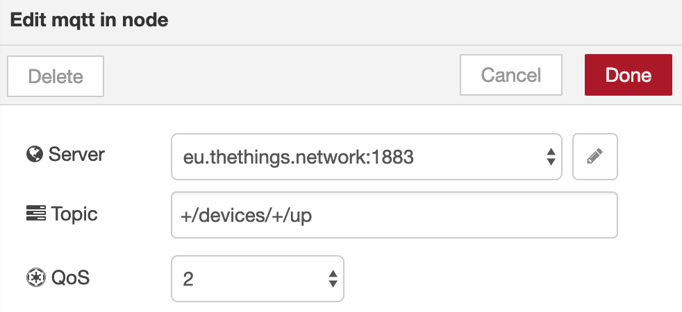

The Node-RED built-in MQTT client node can use wildcards in its subscription, such as +/devices/+/up. Is that what you’re after?
MQTT
For the server’s credentials use the application’s human readable id from TTN Console for the user name, and for the password use an Access Key, with at least the ā€œmessagesā€ right.

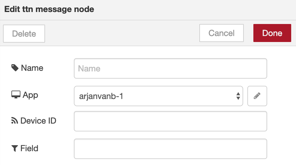

Looking in my Node-RED instance I just found an old, but still operational, TTN message client that did not have any device id configured, and shows uplinks for all devices in that application.
TTN client
But the above surely is an outdated version; I’ve no idea if more recent versions of that library still support this. (I thought I stopped using this TTN Node-RED library long ago…)

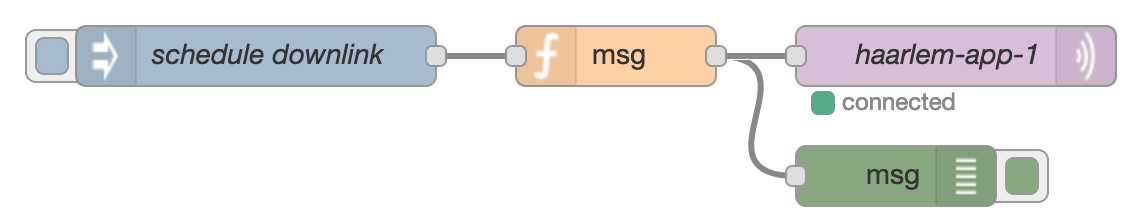

A regular Node-RED MQTT output works just fine for me. Like:
Node-RED
The inject node just injects a boolean true when clicking the button on its left side, which I ignore. In the function node, I’ve used:
const payload = [0x01, 0x02, 0x03, 0x04];
return {
  topic: 'my-app-id/devices/my-device-id/down',
  payload: {
    port: 1,
    confirmed: false,
    payload_raw: new Buffer(payload).toString('base64'),
    schedule: 'replace'
Ok, got it running now, the ā€˜base64’ was the secret sauce…
Thanks for your help!
