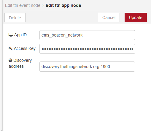

Also, I don’t see how one could even specify this, given the screenshots in the instructions @kersing linked to? However:
Very true when using a regular MQTT client in Node-RED (and, to be honest, that might actually be much easier to understand and use…)
But it seems the TTN library uses that discovery.thethingsnetwork.org:1900 to tell which MQTT server to use, given other parameters such as the application id and region:
That said, I don’t think one can change that discovery address?

According to the documentation in the quick start guide, it points out to either use your private installation address or the public discovery address. I don’t have any MQTT client installed locally so I just left it default since it’s pre-populated with the discovery.thethingsnetwork.org:1900 address.
This is what it shows for me.
