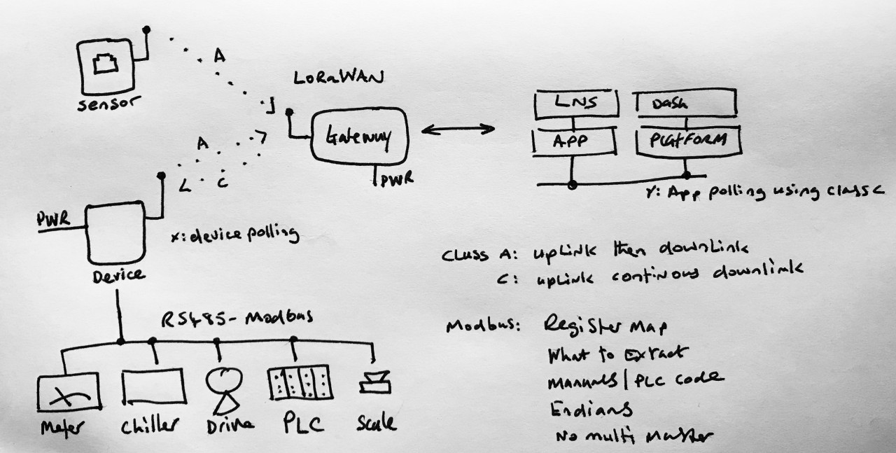

I have I’ve tested URSalink & Dragino RS485 devices to Modbus IO and will look at the new device from RAK soon.
What all the nodes assume is the LoRaWAN device is a Modbus master. Either by polling the PLC grouping the responses and sending an uplink. Or via (transparent mode) when an application server to sends a Modbus read as a downlink to the end device then sends a read to the PLC (slave) and then sends the response as an uplink to TTN/I. I used TTI as wanted to test Class C performance and found it acceptable for the use cases I was looking at.
None of these devices currently support the PLC as a Master which can make it tricky to integrate them into an existing systems. I posted about my my bench testing a while back I didn’t have a PLC to test the time but plan to use a Rockwell micrologic when I do.
