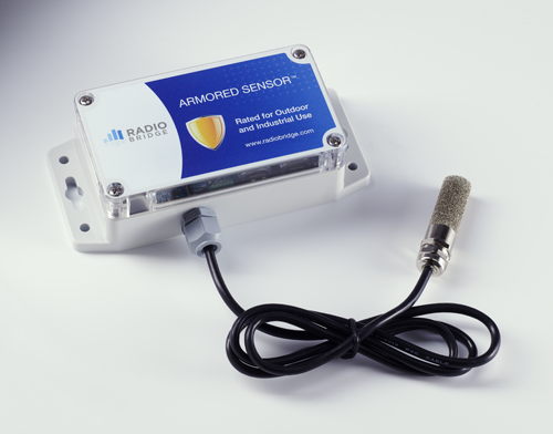

Jac could you clarify your answer for other Radiobridge noobs (like me)? I’d like to register a RadioBridge sensor (external Temp/Humidity) on TTN, and don’t expect to have RadioBridge infrastructure anywhere in the loop - do you have experience of doing this? The RadioBridge documentation seems to give options of adding a ‘RadioBridge’ integration to TTN, or registering your gateway to a RadioBridge network server, but I thought I bought a sensor, not a network service.
