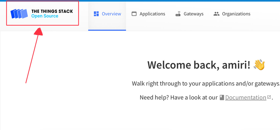

It’s not actually not TTN. It is The Things Stack open source on my own server.
