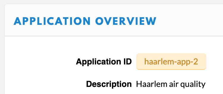

What does ā€œthe name of the applicationā€ mean precisely?
Application overview
Are you referring to the Application ID? (You should.)
I’m wondering as well what was meant, but I’ve been using the Application ID.

mosquitto_sub -h eu.thethings.network -t +/devices/+/up -u haarlem-app-1 -P ttn-account-v2.dY-adpt5dsB1Py4hRaHJ5uvRf3iaiVYzAGpkBMQWNNw
Feel free to try; I’ll remove the above key, switch off the test node and edit this post later tonight. (Yes, it’s a different application ID than shown in the screenshot I posted.)
This temporary key only has access to messages. You can easily add additional keys; maybe that helps, somehow?
