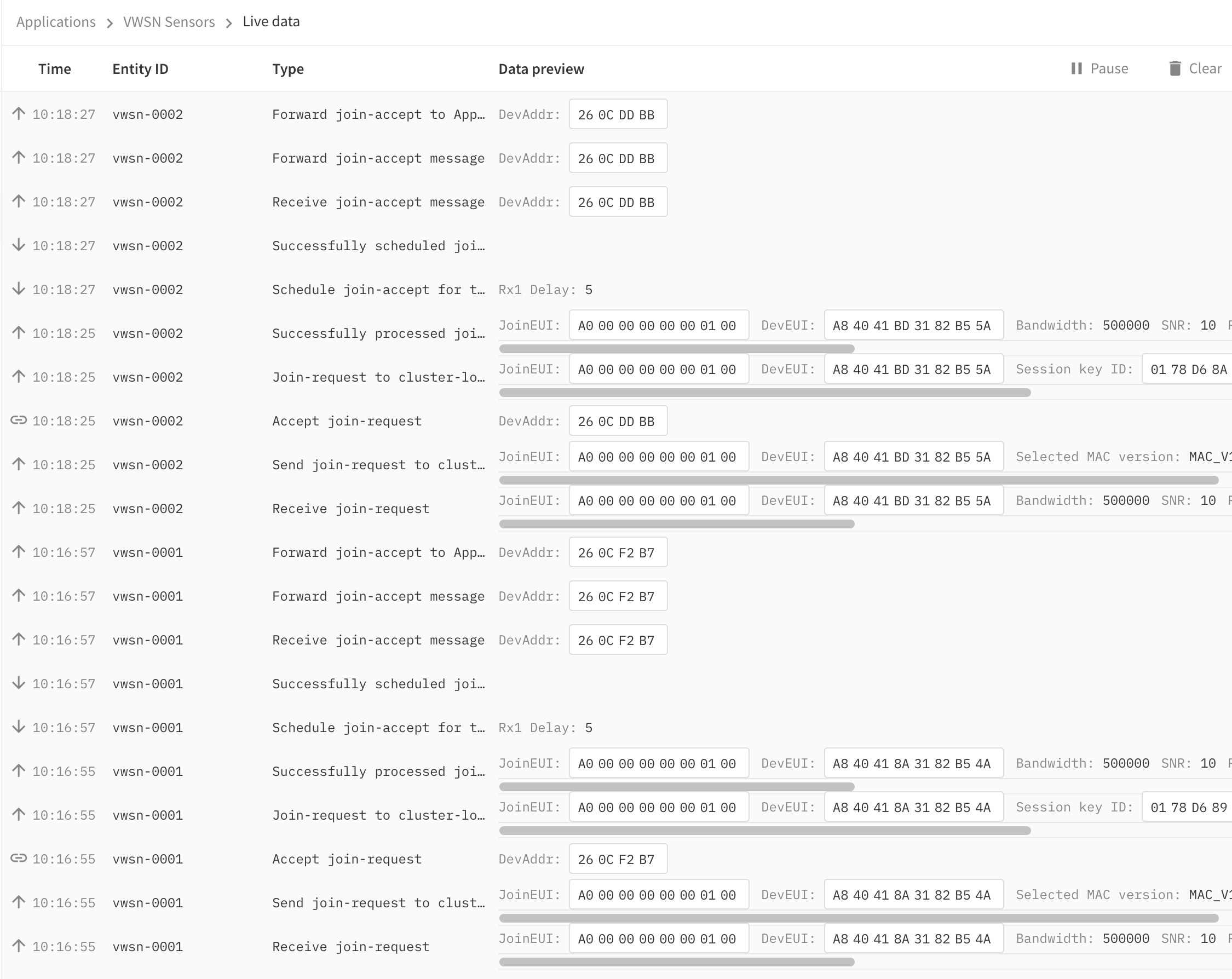

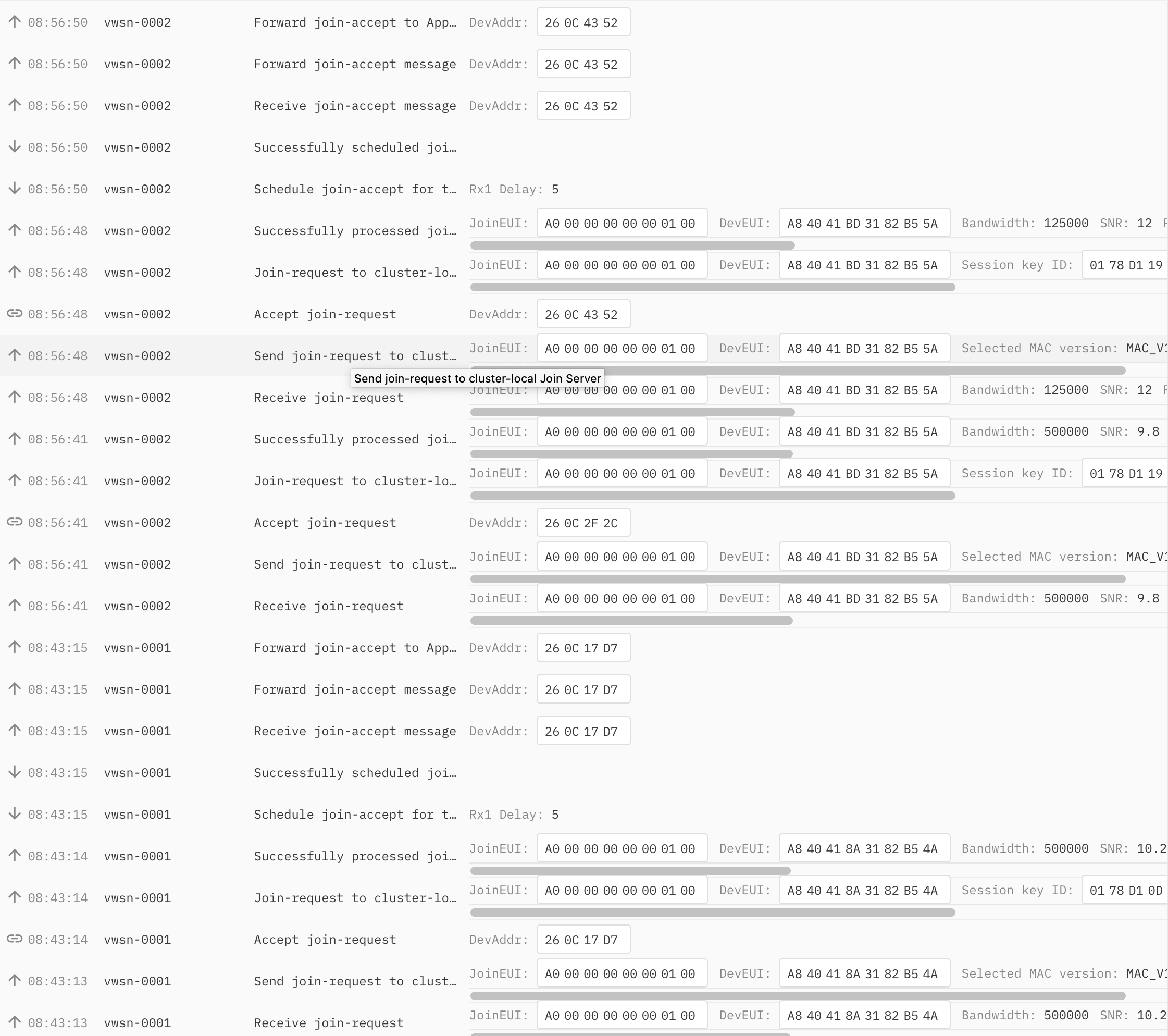

The DLOS8 is outside. The LHT65s are about 4 m and 10 m away from the physical gateway device. I just triggered the LHT65 to try to join and I see the traffic in the TTN v3 gateway console and in the application console. I also see the “join_accept” JSON blobs pass through the TTNc3 webhook to my server. Screen Shot 2021-04-15 at 10.21.53 Screen Shot 2021-04-15 at 10.19.51 I’ll try moving the end-devices farther away from the LSO8.

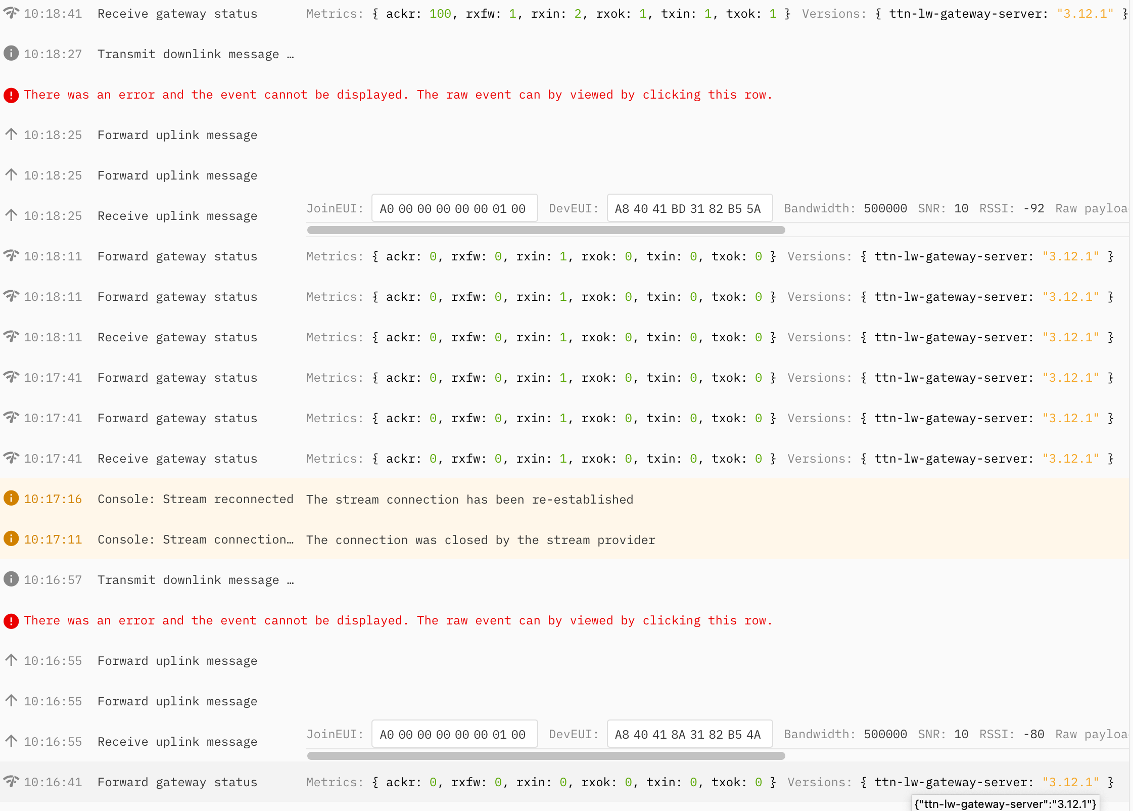

One of the advantages of having problems is that I’ve learned a lot. I updated the LHT65 firmware to v1.8. I was checking settings using the LHT65 serial console when I noticed that it was set to sub-band 1 so I changed that to sub-band 2 for uplink which to my understanding is what the TTIG uses. Unfortunately, I still get the same result as the one you posted on 5/15. My test LHT65 is on TTN v3 and my TTIG is on v2. I rarely see traffic on my v2 TTIG but I do get Application live data on v3 but never a data packet. The last message I ever see in the Application live data is “Forward join-accept to Application Server”.

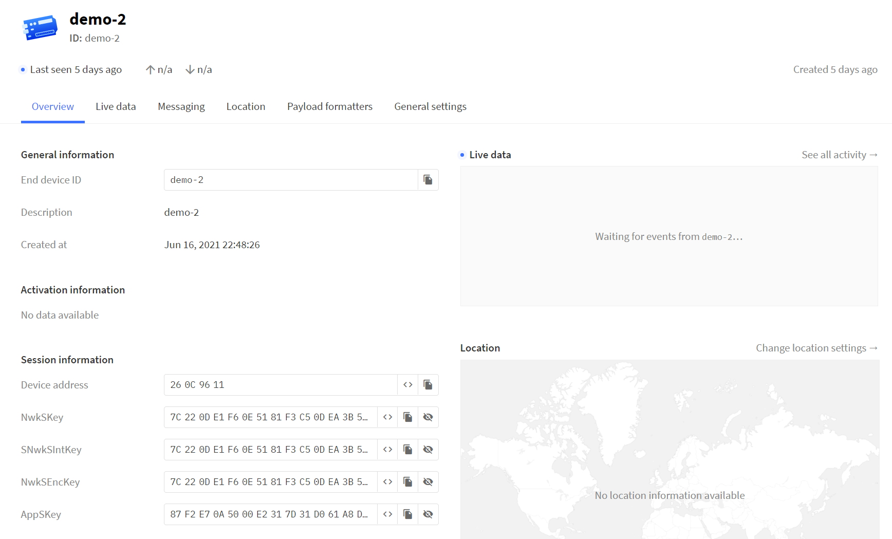

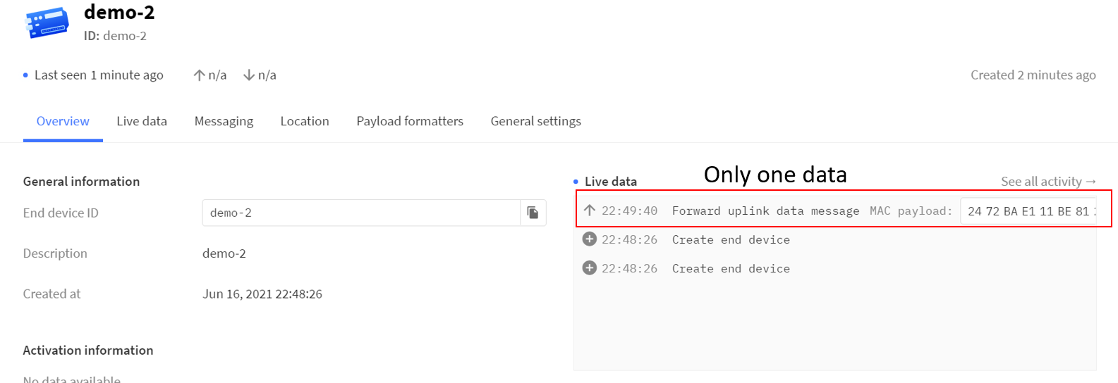

I meet the same problem. I have two device that work on the V2 stack but when using the V3 stack, I just saw one data from end device of application, After got data when I create end device , there is any data:

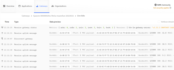

But in gateway of V3 stack, Both devices are working. please refer as below ( Devaddr: 0x2604170C; 0x260B1E72)
image.
Based on the above discussion, I still can’t confirm where the problem in this case.
Please show the activation information of both devices as well.

Please refer as following:
That is one node only. Is that the working one? What about data from the other node?
