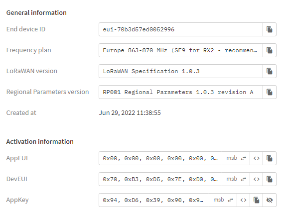

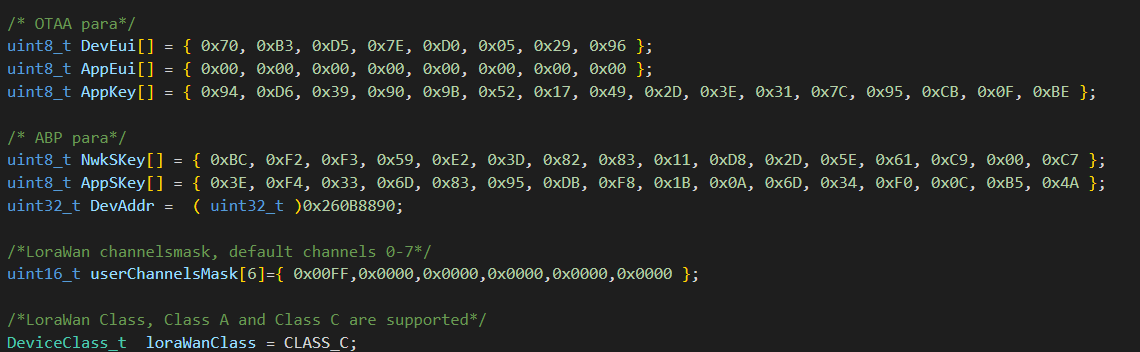

I decided to create a post because I already tried everything I found, so :
I’m trying to connect an end-node (Heltec Wifi Lora 32 V2 - Europe) through my own gateway (Heltec Wifi Lora 32 V2 - Europe too) with OTAA.

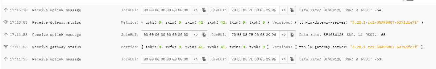

The join request is detected by TTN console but I don’t see any downlink to active the device ?
(All the keys are in msb)
The console :
The end-node :
The Gateway :

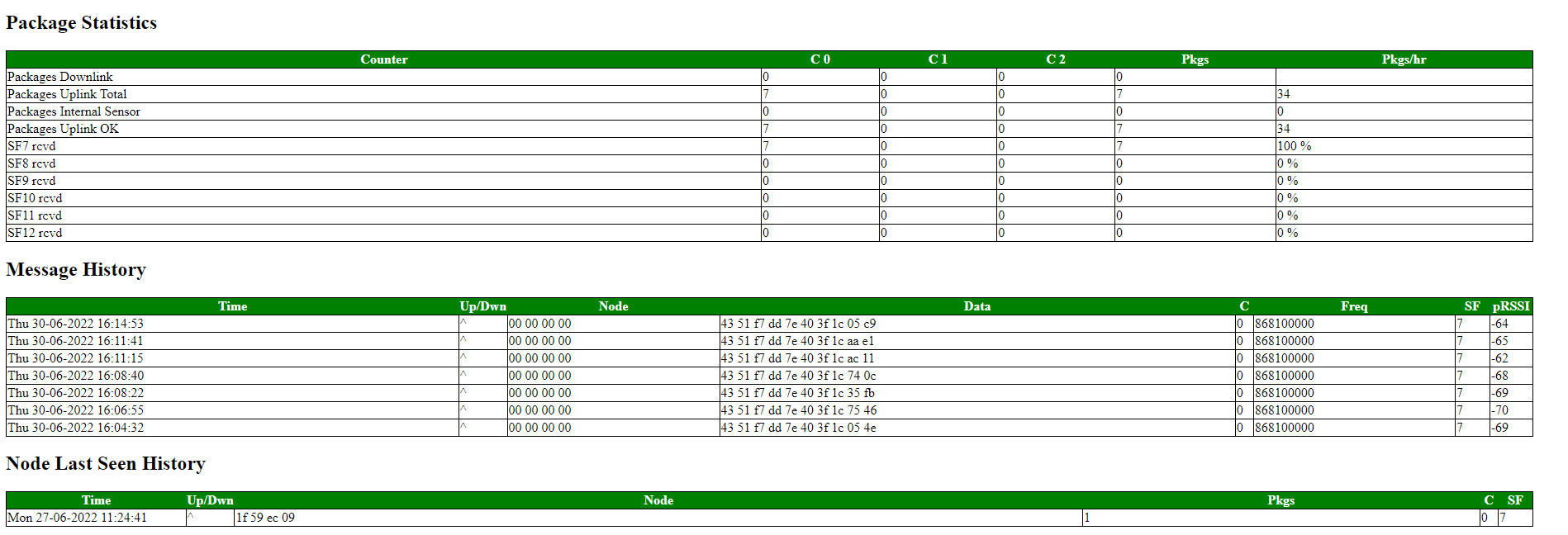

(We can see “0 Packages Downlink”)
If anyone have an idea I’m really stuck…
Thanks
Your using a Heltec Wifi Lora 32 V2 node as a Gateway ?
Jeff-UK
(Jeff Uk)
3
See below and disconnect it from TTN please!
kersing
(Jac Kersing)
4
That is not a gateway and it will not work. Get a real gateway please.
