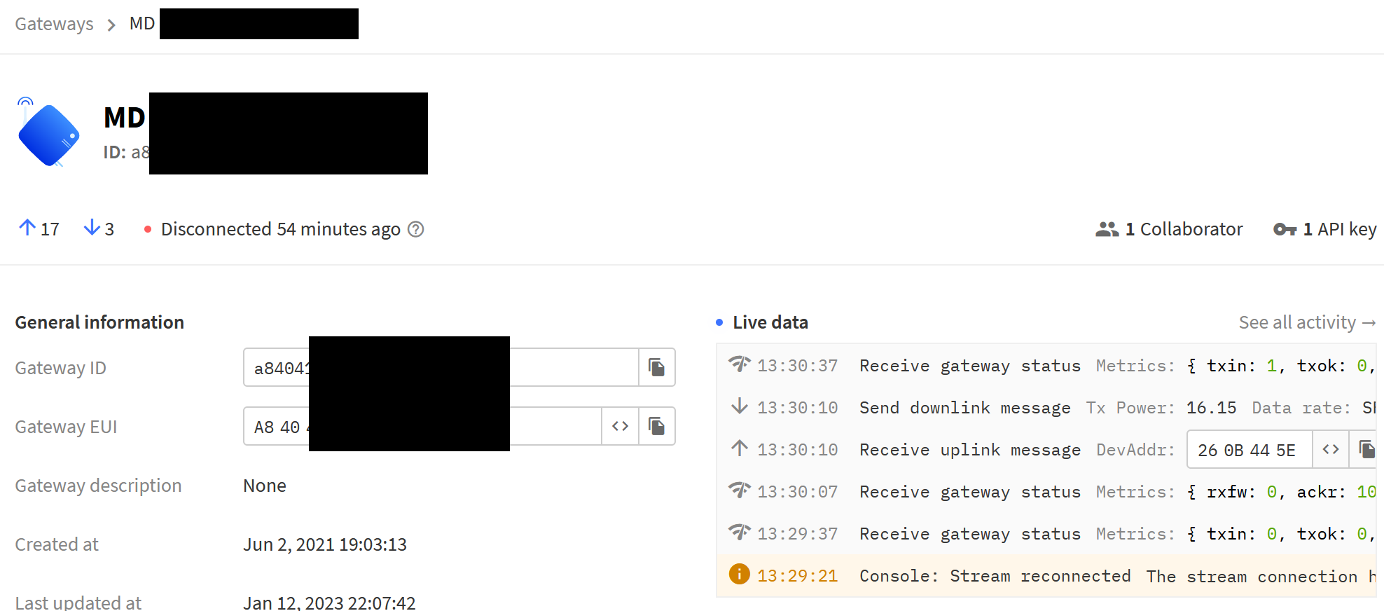

3 out of 4 of my nodes shows Disconnected 20 hours ago (as of now). But inside, I can see receiving packets and gateways status. It just always shows offline. Tried rebooting and everything.
What is disconnected? The gateway or the end devices? Can you add screenshots with EUI/IDs redacted?
Same here. Console shows gateway disconnected, but receive and forward packets.
