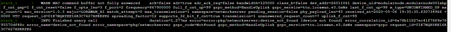

just found this error for the frequencies that are not shown:
stack_1 | WARN MAC command buffer not fully answered ack=false adr=true adr_ack_req=false bandwidth=125000 class_b=false dev_addr=26011061 device_uid=modularnode.modularnode001abp f_cnt_gap=3 f_cnt_reset=false f_opts_len=0 f_port=2 frequency=867300000 full_f_cnt_up=967 grpc_method=HandleUplink grpc_service=ttn.lorawan.v3.GsNs last_f_cnt_up=964 m_type=UNCONFIRMED_UP mac_count=0 mac_version=1.0.1 major=LORAWAN_R1 match_attempt=0 max_transmissions=3 namespace=networkserver pending_session=false phy_payload_len=42 received_at=2020-04-22 19:50:56.189607951 +0000 UTC request_id=01E6HQ2ZDXNDFH9JGCWG1RX9RN spreading_factor=7 supports_32_bit_f_cnt=true transmission=1 unanswered_request_count=8 uplink_f_cnt=967
stack_1 | INFO Finished unary call duration=1.208183ms error=error:pkg/networkserver:device_not_found (device not found) error_correlation_id=693344d005d6498398c1f74fc2f975e1 error_name=device_not_found error_namespace=pkg/networkserver grpc_code=NotFound grpc_method=HandleUplink grpc_service=ttn.lorawan.v3.GsNs namespace=grpc request_id=01E6HQ2ZDXNDFH9JGCWG1RX9RN

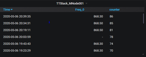

if i use telegraf and mqtt i only get packages for channel index 1 and 2

just tested mqttbox with the same results as using telegraf.
it looks like tt stack does not send all data via mqtt.

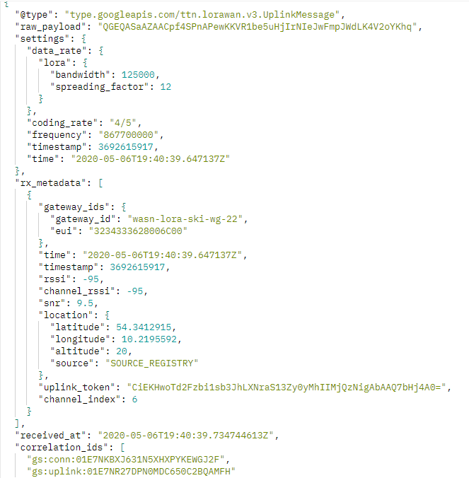

in the webui i get:
the same package is going to TTN and a chirpstack server and is decoded without problems

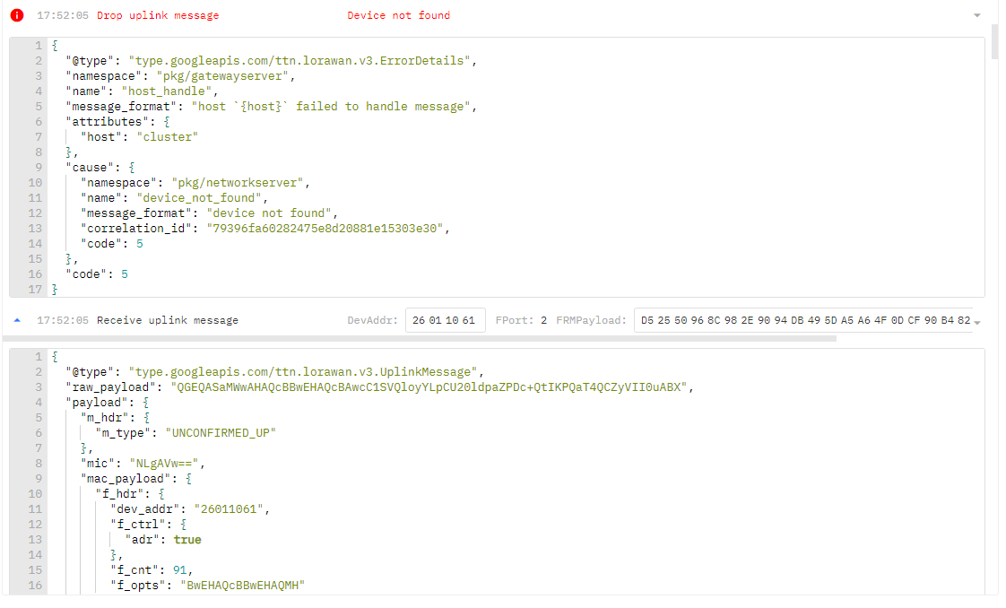

the things stack gets this packages:
the gateway has more received:
if the package is not shown (channel index 3-7) i get a device not found error
why is the device not found when i see the id of the device in the log?
in the web ui i see this:
followed by this:

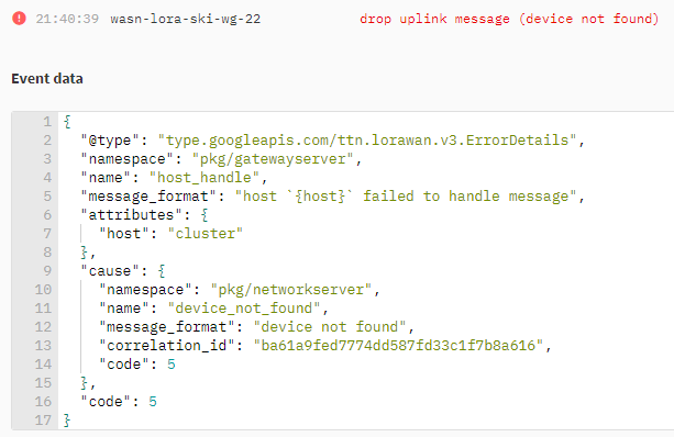

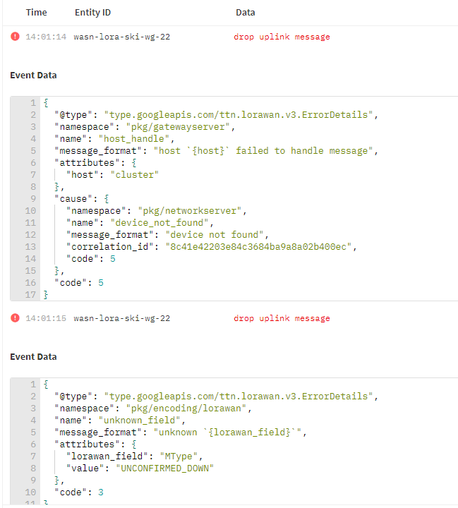

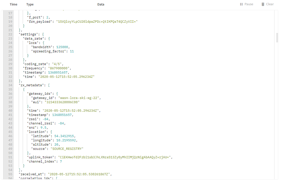

still having device not found error:
why do i get a device not found error when the DevAddr is the right one
kersing
(Jac Kersing)
May 12, 2020, 4:25pm
20
That can happen if the MIC calculation for that device using the key doesn’t match. The uplink packet is not corrupted?
wasn
(WASN)
May 12, 2020, 4:28pm
21
crc check for that package on the gateway is ok.
the same package is send to TTN, TheThingsStack and Chirpstack.
all servers except thethingsstack can use the package
