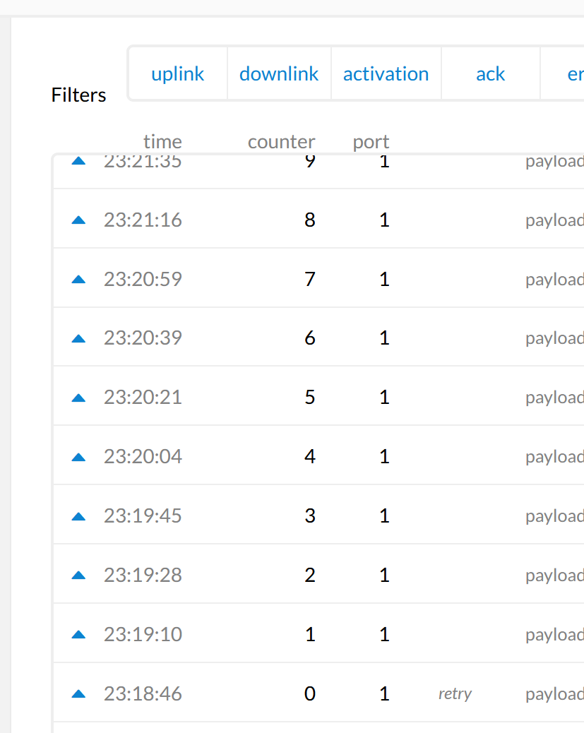

Hello
I tried abp and it work. But I could not see any OK

4
LMIC library print me that
1006888: EV_TXCOMPLETE (includes waiting for RX windows)
So for me, it’s look good

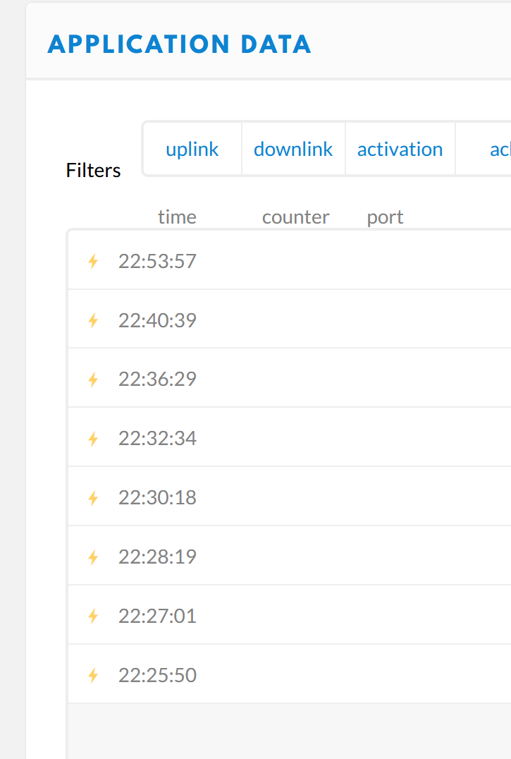

cslorabox
(Cslorabox)
6
Are you sure join accepts are even being generated?
None are shown…
kersing
(Jac Kersing)
7
In the application data you will only see the yellow lightning symbol if a join accept is generated.
For me it does not, you need to receive actual data, not only ‘wait’ for it.
