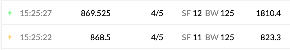

Looking at Gateway console I can see Join Accepts are sent but it seems the nodes are not receiving these Accepts.
OTAA Join in TTN Console

Do you know at what SF the nodes start the OTAA? (The screenshot shows SF12, but they might have started with a better SF?)

Thank you both very much for taking the time to reply to my post, your ideas spawned further troubleshooting avenues which I’m pleased to report yielded results. Arjan was on the money, latency had indeed increased.
My downlink test which I thought succeeded had indeed failed (it was late and I had to wait some 30 minutes for the next uplink and I had assumed it went through…) Another clue: All the existing live devices on the farm have ADR enabled and when I looked at them they were all transmitting on SF12 where usually they’re on SF7. I then viewed their logs and yup, the last few days they started ramping up from SF7 - SF12. This particular farm has a wired TTOG, and I started connecting the dots – in South Africa we rely on international internet traffic to reach TTN servers, an undersea cable snapped a few days ago and shortly after the data rates started increasing. A quick call to the farm’s ISP to reroute traffic and bang, all devices back to SF7 and OTAA joins going straight through… so there you have it… a broken sea cable.
