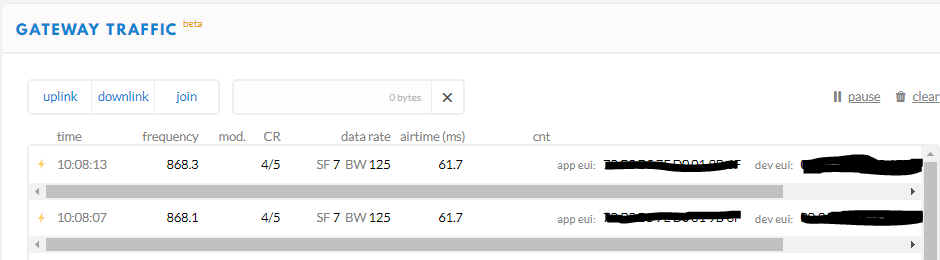

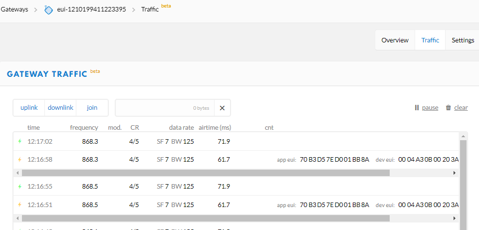

(Surendar) #10
Dear Team,
I have created an application and I have added two devices. But my devices do not join the network. But on the gateway traffic, I can able to see the join request and join accept message but on the application side, I didn’t receive any message. I am using EU frequency and EU handler for the application and the gateway.
image .
How shall I resolve this?
