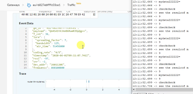

ref your Q1; The timestamp shown is the time as received by the network server. The timestamp is in ISO8601 format. The “Z” on the end is for “Zulu” time which is UTC.

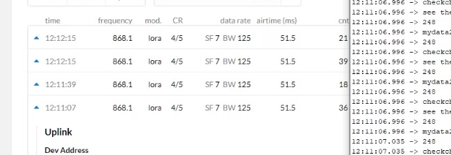

ref your Q2; The web console list page only shows hh:mm:ss. When you expand it as you appear to have done in the image you show it shows the full JSON including the ISO8601 timestamps with the fraction of the second.

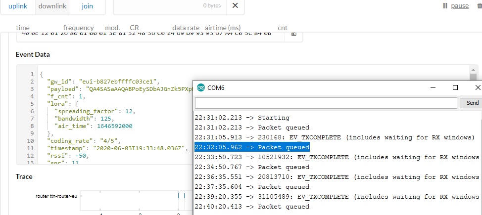

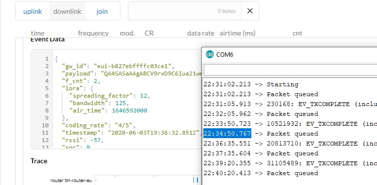

thanks for the replay. I think it must be accurate but when today’s test I got more than one min differences as shown in the pic for two different packets
Well, I hope you understand what that means.

LMiC doesn’t typically produce any debug output when it actually transmits, because it then has to open precisely timed receive window(s) shortly thereafter and typical ways of producing serial output on an MCU incur some delay which the authors of various ports have some concern could disrupt the receive window timing if not implemented with a high degree of care.
The practical result is that in your logs the actual transmission go out just a few seconds before the EV_TXCOMPLETE messages, NOT at the Packet queued messages - those have to be interpreted a bit literally, the packet has been staged but NOT yet sent.
