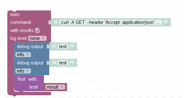

var obj = JSON.parse(testi);
console.warn(testi.degreesC)
grafik
Your input is a JSON list parsed into the obj variable.
To access the first item degreesC property:
console.log(obj[0].degreesC)
